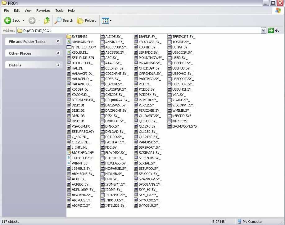

Megahurt Posted October 21, 2005 Author Posted October 21, 2005 I followed flyakite's guide as closely as possible. I created the PRO1 folder in the root of my DVD, I have PRO1.DAT in the root of the DVD as well and I Hex edited it to point to the PRO1 folder by replacing I386.Perhaps I am missing a few files in the PRO1 folder. How many, and which files should be in there?patiently awaiting answers,Megahurt

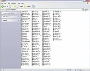

amd64lover Posted October 21, 2005 Posted October 21, 2005 i have attached a screenshot of the files in my PRO1 folder... there are two files in the system32 folder, smss.exe and ntdll.dll... the setupldr.bin file needs to be edited, as does the txtsetup.sif... you may or may not need the winnt.sif file depending on whether or not you are doing an unattended setup.
Megahurt Posted October 22, 2005 Author Posted October 22, 2005 (edited) I checked the folder, the only files that I am missing in the PRO1 folder are the Disk10x files. I have all the rest of them. It finally booted but errored out and said that I was missing one of the files. So now I need to fix that. The actual error that I get now is, "Setup can not find usbohci.sys, setup will not continue." That file is on my dvd in the PRO1 folder, so I don't know what the problem is.Thanks for the help.Megahurt Edited October 22, 2005 by Megahurt
Megahurt Posted October 22, 2005 Author Posted October 22, 2005 Okay, I got it working again. I just copied the file back over from the original cd.Now I have another question, what files on the DVD can I make hidden and still have it work?Megahurt
