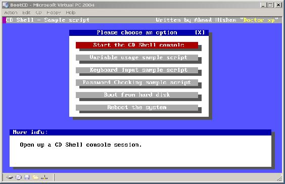

Halonix Posted September 26, 2005 Posted September 26, 2005 (edited) I am trying to create a bootable CD with an unattended install of 2003 (which works fine on its own) and Windows PE. I was trying to use the Multiboot DVD tutorial as my reference. I did everything that was instructed in the tutorial but I cannot boot from the CD. I understand the PE one, I get a NTLDR missing error. But I am also unable to boot the 2003 install. I get a Code 5 error. I did everything just as instruted in the tutorial with some minor directory name changes. I edited all the bin files with Hex workshop, using only caps, and I created the ISO with cdimage. Im not sure what Im doing wrong here. Also, I edited my cdshell.ini file from the sample in the tutorial taking out only obviously non-crucial things, and changing some of the menu items. But when it boots off the CD it loads straight into a cdshell screen with some sample script buttons and stuff. I actually have to go to the command line and chain my dat files to load them. If Im doing something worng please let me know. Edited September 26, 2005 by Halonix

Halonix Posted September 27, 2005 Author Posted September 27, 2005 The boot folders must be 4 characters...no more, no less.If this was my cd. i would....- Change WINPE back to I386 since it is that by default and it is easier to add to other distrosin the future. Also relieves minor naming convention problems that you could run into.- Change WiIN2003 just to 2003 since you only have one 2003 OS in this distro.Don't forget to edit SETUPLDR.BIN in each of the boot folders as well as the bootable dat files accordingly. Also, since mistakes are bound to be made, it wouldn't hurt to double check your OS path in txtsetup.sifHave Fun B)<{POST_SNAPBACK}>Good to know I will change them all back to 4 chars. I dont think it said that in the tutorial, though all of his folders were only 4 characters. Yea I edited all of the setupldr.bin files as well as the txtsetup.sif files. In fact I have heavily modified my 2003 sif file to copy a bunch of other software to the install as well. Thank you very much for the advice, I will give that a shot. Any idea why Im geting that cdshell screen instead of my custom menu?here is my cdshell.iniboot:clsprint "\n"print "Press Enter to boot from CD... \n"getkey 5 boot 0x80if $lastKey == key[enter]; then goto time# When no key found...goto boot# Function to display time of daytime:set hour = $timeHourset ampm = "am"if $timeHour > 12; then set hour = $timeHour - 12if $timeHour > 12; then set ampm = "pm"set time = "$hour:$timeMinute$ampm"# Function to display datedate:set month = "n/a"if $dateMonth == 1; then set month = "Jan."if $dateMonth == 2; then set month = "Feb."if $dateMonth == 3; then set month = "Mar."if $dateMonth == 4; then set month = "Apr."if $dateMonth == 5; then set month = "May."if $dateMonth == 6; then set month = "Jun."if $dateMonth == 7; then set month = "Jul."if $dateMonth == 8; then set month = "Aug."if $dateMonth == 9; then set month = "Sep."if $dateMonth == 10; then set month = "Oct."if $dateMonth == 11; then set month = "Nov."if $dateMonth == 12; then set month = "Dec."set date = "$month$dateDay,$dateYear"# Printing the Interfacemenu:set textColor= color[grey on black]set boldColor= color[cyan on black]clsprint c "\n\cXXÄÄÄÄÄÄÄÄÄÄÄÄÄÄÄÄÄÄÄÄÄÄÄÄÄÄÄÄÄÄÄÄÄÄÄÄÄÄÄÄÄÄÄÄÄÄÄÄÄÄÄÄÄÄÄÄ<\c0B$time $date\cXX>ÄÄ \n\n"print c "\cXXÄÄÄÄÄÄÄÄÄÄÄÄÄÄÄÄÄÄÄÄÄÄÄÄÄÄÄÄÄÄÄÄÄÄÄÄÄÄÄÄÄÄÄÄÄÄÄÄÄÄÄÄÄÄÄÄÄÄÄÄÄÄÄÄÄÄÄÄÄÄÄÄÄÄÄÄÄÄ \n\n"print "1) Windows Server 2003 Corporate \n"print "2) Windows Pre-Installation Environment \n"print "\n"print "Q) Quit to Command Prompt \n"print "R) Reboot \n"print "ESC) Boot 1st Harddisk \n"print c "\n"MainKey:getkey 20 boot 0x80if $lastKey == key[1]; then chain /WIN2003.DATif $lastKey == key[1]; then chain /WINPE.DATif $lastKey == key[q]; then endif $lastKey == key[r]; then rebootif $lastKey == key[F1]; then goto Helpif $lastKey == key[esc]; then boot 0x80end
Screwz Luse Posted September 27, 2005 Posted September 27, 2005 (edited) uuummm.. I'm not sure but usually cdshell.ini is in the cdshell folder (usually named /BOOT/, although I have it named CDSH on my DVD and hex edited so that it points to /CDSH/ instead of /BOOT/). I don't have my cdshell.ini file in the root of my dvd.And noticed that you have if $lastKey == key[F1]; then goto Help even though you have no Help section. That won't cause any problems (unless someone hits F1), but just something I thought I'd point out. Edited September 27, 2005 by Screwz Luse
Halonix Posted September 27, 2005 Author Posted September 27, 2005 uuummm.. I'm not sure but usually cdshell.ini is in the cdshell folder (usually named /BOOT/, although I have it named CDSH on my DVD and hex edited so that it points to /CDSH/ instead of /BOOT/). I don't have my cdshell.ini file in the root of my dvd.And noticed that you have if $lastKey == key[F1]; then goto Help even though you have no Help section. That won't cause any problems (unless someone hits F1), but just something I thought I'd point out. <{POST_SNAPBACK}>I had it in the BOOT folder as well, I wasnt quite sure where to put it so I put it in both places. I got Windows PE to boot, but now I seem to be having issues getting my 2003 setup to load. I get a NTLDR is corrupt message.
