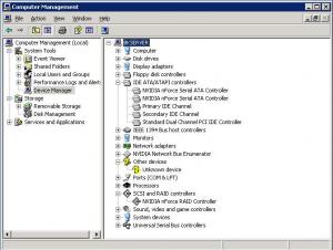

badkarma Posted May 4, 2008 Posted May 4, 2008 if you don't install the OS onto a RAID partition, the OS Setup won't automaticly install the needed nForce S-ATA driver.Solution:Open the Device Manager and check within the "SCSI and RAID Controllers" section, if the "NVIDIA nForce RAID Controller" is correctly installed (by using the nForce RAID driver).If yes, do the following:1. Open the "IDE/ATAPI Controllers" section of the Device Manager. You will see a lot of devices named "Standard Dual Channel PCI IDE Controller".2. Check, which of them is managing your natively IDE connected devices (for example CD-ROM/DVD).3. Right-click onto all other "Standard Dual Channel PCI IDE Controllers" - one after the other - and let the Device Manager show all compatible devices ("Update Driver Software" > "Browse my computer ...." > "Let me pick ...."). Choose the listed "NVIDIA nForce Serial ATA Controller". 4. After having replaced all "Standard Dual Channel PCI IDE Controllers" by the "NVIDIA nForce Serial ATA Controller" (UNLESSS the one, where your natively IDE devices are connected), you can reboot.Now your RAID array should be correctly detected by your OS.Good luck!FernandoThanks Fernando but it didn't seem to work. I only have 1 "Standard Dual Channel PCI IDE Controller". I tried to use "Nvidia nforce Seral ATA Controller" driver but when I rebooted the device is unable to start and no RAID in OS.
Fernando 1 Posted May 4, 2008 Author Posted May 4, 2008 Thanks Fernando but it didn't seem to work. I only have 1 "Standard Dual Channel PCI IDE Controller". I tried to use "Nvidia nforce Seral ATA Controller" driver but when I rebooted the device is unable to start and no RAID in OS.Look into the "SCSI and RAID Controllers" section.Which devices are listed there?
badkarma Posted May 4, 2008 Posted May 4, 2008 Thanks Fernando but it didn't seem to work. I only have 1 "Standard Dual Channel PCI IDE Controller". I tried to use "Nvidia nforce Seral ATA Controller" driver but when I rebooted the device is unable to start and no RAID in OS.Look into the "SCSI and RAID Controllers" section.Which devices are listed there?NVIDIA nForce RAID Controller onlySee attached screenshot.
Fernando 1 Posted May 4, 2008 Author Posted May 4, 2008 Thanks Fernando but it didn't seem to work. I only have 1 "Standard Dual Channel PCI IDE Controller". I tried to use "Nvidia nforce Seral ATA Controller" driver but when I rebooted the device is unable to start and no RAID in OS.Look into the "SCSI and RAID Controllers" section.Which devices are listed there?NVIDIA nForce RAID Controller onlySee attached screenshot.Thanks for the reply and the Device Manager screenshot. As far as I can see everything seems to be fine.What sort is that "unknown device"? Please try to find out the HardwareID of this device (> right-click onto the device > "Properties" > "Details")
badkarma Posted May 4, 2008 Posted May 4, 2008 Thanks for the reply and the Device Manager screenshot. As far as I can see everything seems to be fine.What sort is that "unknown device"? Please try to find out the HardwareID of this device (> right-click onto the device > "Properties" > "Details")ACPI\PNP0510*PNP0510I haven't been able to figure out what this is. Whenever I tried to manually install driver sfor it it never works.Thanks for the help Fernando.
Fernando 1 Posted May 4, 2008 Author Posted May 4, 2008 What sort is that "unknown device"? Please try to find out the HardwareID of this device (> right-click onto the device > "Properties" > "Details")ACPI\PNP0510*PNP0510I haven't been able to figure out what this is. Whenever I tried to manually install driver sfor it it never works.I think, that it is the infrared device, which you obviously have removed by nLite. The missing MS drivers are named irsir.sys and serial.sys.Now back to your RAID5 issue:Since I had the same mainboard, I doubt, that the DFI Lanparty NF4 Ultra-D is fully supporting nForce RAID5. That is probably the reason why your RAID hasn't been detected by the OS.
badkarma Posted May 4, 2008 Posted May 4, 2008 What sort is that "unknown device"? Please try to find out the HardwareID of this device (> right-click onto the device > "Properties" > "Details")ACPI\PNP0510*PNP0510I haven't been able to figure out what this is. Whenever I tried to manually install driver sfor it it never works.I think, that it is the infrared device, which you obviously have removed by nLite. The missing MS drivers are named irsir.sys and serial.sys.Now back to your RAID5 issue:Since I had the same mainboard, I doubt, that the DFI Lanparty NF4 Ultra-D is fully supporting nForce RAID5. That is probably the reason why your RAID hasn't been detected by the OS.Dang, you're right. I just checked the specs and RAID5 isn't listed. I wonder if the pencil mod to make the Ultra-D an SLI-D adds RAID5 functionality.
Fernando 1 Posted May 5, 2008 Author Posted May 5, 2008 Since I had the same mainboard, I doubt, that the DFI Lanparty NF4 Ultra-D is fully supporting nForce RAID5. That is probably the reason why your RAID hasn't been detected by the OS.Dang, you're right. I just checked the specs and RAID5 isn't listed. I wonder if the pencil mod to make the Ultra-D an SLI-D adds RAID5 functionality.Ok, then we have detected at least the reason for your problem.RAID5 is only supported by newer mainboards.
