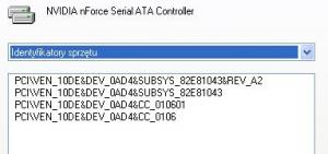

krzysiek033 Posted October 28, 2009 Posted October 28, 2009 (edited) Finnally its working. I had to use different windows CD to integrate drivers in it.So you did not take a clean XP CD as source? Then you didn't read my guide carefully.It was not easy to help you, because you didn't answer all my questions and your few answers have always been hidden within your quoted text. Nevertheless it's fine, that you succeeded at least.Last questions (hoping for an answer):1. Which of the different drivers worked for you at least?2. Which HardwareID's has your freshly installed "NVIDIA nForce Serial ATA Controller"?Thank you so much for your help, Great tutorial btw. 1. I used drivers from ur guide, but orginal from my motherboard's CD are working too (ver. 10.3.0.46).2. see attachment (I have polish windows version but its HArdware ID. Edited October 28, 2009 by krzysiek033
Fernando 1 Posted October 28, 2009 Author Posted October 28, 2009 @ krzysiek033:Thanks for your reply.The attached HardwareID's of your now in AHCI Mode running "NVIDIA nForce Serial ATA Controller" were a surprise for me, because according to my knowledge they belong to MCP78 (nForce 730a/720a/710a) and not to MCP72 (nForce 780a/750a) chipsets.Have fun with your freshly installed Windows XP running in AHCI Mode!Fernando
