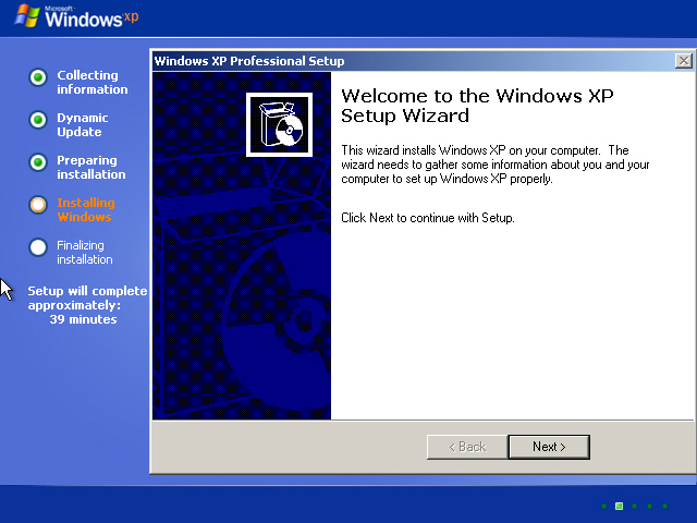

post-48757-1121189833_thumb.jpgHi everyone, what a fantastic forum !!
I am in the process of making my own Unattended install of XP and at the moment I have done the SP2 slipstream, Hotfixes and Apps etc; with great success thanks to MSFN and this forum. The build has been very successfull apart from one little niggle - At T-39 to T-37 I get a setup wizard appear and until I click the OK button it hangs at that point. After I click it the install continues successfully until completetion. Clicking the OK button on the wizard doesn't appear to invoke anything.
Can anyone help me with this niggle.

Hi, I think the problem lies in Winnt.sif
Winnt.sif

I am having the same issue and it is very fruuuustrating to have it pop up and not continue. I have tried and looked at several different styles of [unattended] commands and found no resolve. I am surprised to see you using 'UnattendMode=FullUnattended' and still seeing that failure point. I wish I could help out more. Here is what I am using with the same problem.

UnattendMode=FullUnattended seems to be correct as I found what was causing my problem - I just needed to add the following...
Under [GuiUnattended]
Oemskipwelcome=1
Since adding that entry my unattended setup runs without stopping at that annoying Setup Wizard.
Hopes this helps
