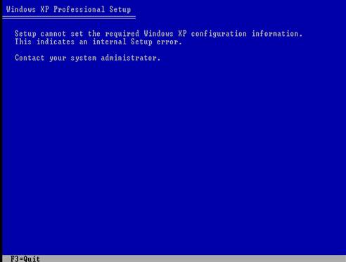

Can someone help me with this ? Its not mentioning any perticular file where the error is occuring..
WinXP SP2 slipstreamed a few modifications to boot screen etc etc...
Setup manages to copy all the files from the .iso file it loads HIVESYS.INF & while saving the configuration information I get this error.
Tried it both with VMware 5 & Virtual PC, no go :(
I used nlite latest build .99 to remove some language packs no tweaks
I think that this is correct, if u replaced the ntoskrnl.exe with a different one to change the boot screen, SP2 doesnt "really" use this file for this purpose anymore. It may use it to some extent but not like it did before SP2, thats why SP2 no longer displays the version (Home or Pro) that you are using, u may want to try to do it without replacing any of the system files until the system actually installs.
