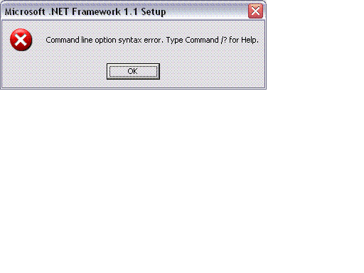

The Hunter Posted February 13, 2005 Posted February 13, 2005 Hi I am doing this unattended cd for the first time. When using the Integrate switch and the nlite method I m getting errors like the one attached when attaching software updates like ms journal viewer, .net framework etc. Can someone pls explain how can I solve this?TnxThe Hunter
Alanoll Posted February 13, 2005 Posted February 13, 2005 it's simple....HOTFIXES for CORE WINDOWS COMPONENTS use the Integrate switch. There are a few exceptions (IE and OE updates, and MDAC) that don't support it as well.The one syou're trying to use are software updates or addons, which can be considered seperate applications and as such you need to find the switch yourself and add it to your install routine.(The caps were to emphasize when others come across this thread)
