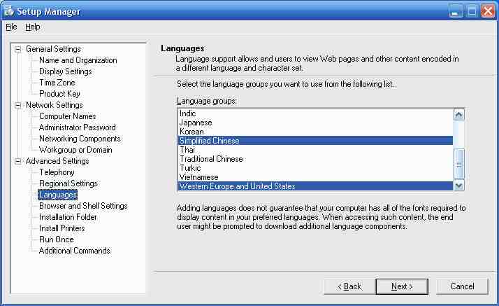

prathapml Posted January 17, 2005 Posted January 17, 2005 You create your winnt.sif using Setup Manager (from deploy.cab), don't you?See the regional settings screen more closely, for advanced/custom.
argon007 Posted January 17, 2005 Author Posted January 17, 2005 Yeah, I have created winnt.sif by Setup Manager..but I did not see the setting that you describe..I use Windows XP SP2 Deployment tools..any idea?

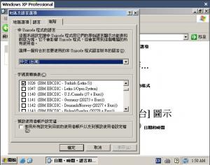

argon007 Posted January 18, 2005 Author Posted January 18, 2005 We are referring to this screen:No, I just want to install the stuff like 20000 (CNS-Taiwan) and etc.(you scroll down and will see more uncheck box.) That means the 20000 and etc will not be installed as default. (Unattended XP CD)so how to get the those things?
prathapml Posted January 18, 2005 Posted January 18, 2005 Those are language groups. Install it, and then after setup you can get related languages and keyboard layouts (like your CNS-Taiwan).
argon007 Posted January 18, 2005 Author Posted January 18, 2005 Those are language groups. Install it, and then after setup you can get related languages and keyboard layouts (like your CNS-Taiwan).Thank you for replying, but I installed it unattendedly, it was not checked.so how to do?please see the below picture from VMware.
prathapml Posted January 18, 2005 Posted January 18, 2005 You need to enable it yourself manually - and use regshot to monitor the changes to do it automatically next time.
argon007 Posted January 18, 2005 Author Posted January 18, 2005 ok.. next time i will try regshot. anyway, thank you for replying.
