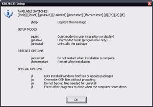

No clue what's causing your problem. All I know is KB828035.exe /Q /O /N /Z installs fine for me using RunOnceEx.cmd, which is odd considering those are not the correct switches according to my screenshot below. Sometimes you have to look up the hotfix in question on microsoft.com. Trial and error I guess. As far as windows update goes, I don't even bother with it. If you take the proper steps, then sp2 and most of the pre-sp2 hotfixes are not needed.
All of the hotfixes, as far as I know, will tell you all? of their switches. Open a cmd window in the same folder as the hotfixes, and type the hotfix filename with /?
Example: KB828035.exe /?
This will cause the hotfix to pop up a window with all of it's switches. I've attached a screenshot of the help window for KB828035.
