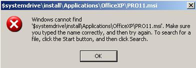

wnr Posted October 20, 2004 Author Share Posted October 20, 2004 Hmm i seem to have a problem with office still:this is the entry in the cmd:REG ADD %KEY%\070 /VE /D "Installing Microsoft Office XP" REG ADD %KEY%\070 /V 1 /D "$systemdrive%\install\Applications\OfficeXP\PRO11.msi TRANSFORMS=Unattended.MST /qb-" /f Link to comment Share on other sites More sharing options...
Jito463 Posted October 20, 2004 Share Posted October 20, 2004 REG ADD %KEY%\070 /V 1 /D "$systemdrive%\install\Applications\OfficeXP\PRO11.msi TRANSFORMS=Unattended.MST /qb-" /fNote the $ in bold. It should be %If you read your error messages, you'll find out a lot about what went wrong. Link to comment Share on other sites More sharing options...
wnr Posted October 20, 2004 Author Share Posted October 20, 2004 Thanks, sorted that, gonna test it Link to comment Share on other sites More sharing options...
