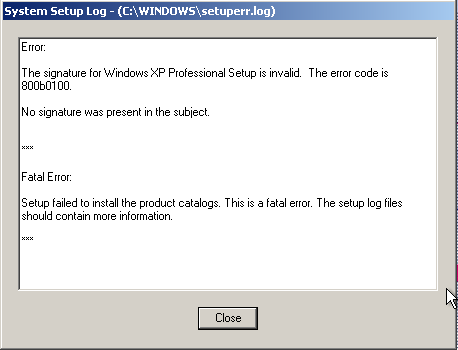

Adiel Posted October 9, 2004 Posted October 9, 2004 Hallo,I'm now testing my Unattended XPCD using VMware WorkStation and when i get tothe install part i get a Fatal Error here's a picture : (copy full link 2 address bar)http://rotter.name/madric/guide/4166869a27575a7d.jpgi searched the forum and fount out that other people had the same problem, and i tried the answers on the search but no luck.i've edited winnbbu.dll nad WINNT32U.dll , and i used modifyPE on them and on the uxtheme.dll file,made cabs for all those files and copied over the the ones in I386 folder. i can't seem to find the problem.If anyone knows how to solve it - please tell me ,Thanks.

Adiel Posted October 10, 2004 Author Posted October 10, 2004 nvm , found the problem -i didn't use the reg file that needed for disabling WFP
