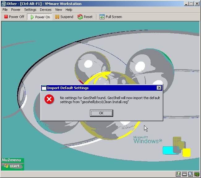

No settings for Geoshell found !?
with start of winPE get I an error message (see picture)
I tested this WINPE with VMWare and functioned everything. on my MultiDVD starts winpe with this error message
"No settings for Geoshell found.
Geoshell will now import the default settings from "Geoshell\docs\clean install.reg"."
What is wrong with my winPe on my MultiDVD
thanks for the assistance !
Did you move your geoshell directory from the root driectory? It looks like that is where it is looking to load the registry file. As an aside, you should really look into building your own PE disc, its really not that hard (Unless you did and just borrowed the wallpaper from another, less than legal, pe disc). Then you can also be fairly sure whats going wrong when stuff fails, since you added the stuff to it yourself.
Cheers
have you tried manually loading the reg file and then running geoshell?

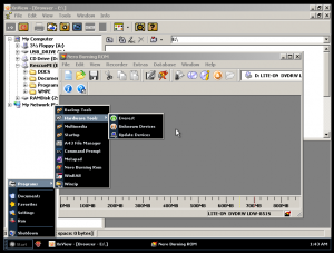

I load my geoshell settings as part of my cd build, it works fine. Here's a screenshot:

  • Author
where kan I start the file manually and what is the name of this file :wacko:
