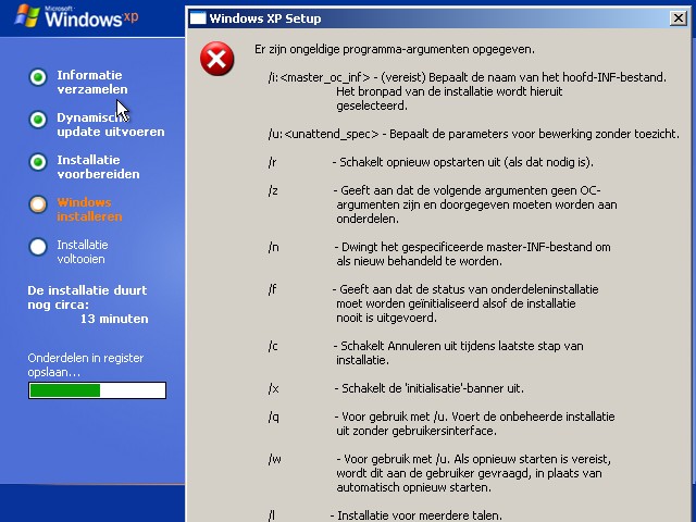

sub0 Posted June 17, 2004 Posted June 17, 2004 See image, i hope you understand.But how can i find out what causes this problem? where should i look?

sixpack Posted June 17, 2004 Posted June 17, 2004 ok try thisrepleas this:/Q /O /N /Zfor this:/Q /N /Z /ONOT SVCPACK.INF SUPPORTED - Anything shown below must not be processed by svcpack. Instead, these should be installed on first logon to process silent unattended installations of these updates.Q817787 (Switch: /Q:A /R:N) (6th May 2003)Flaw in Windows Media Player Skins Downloading Could Allow Code ExecutionDownload - 360 KBNote: This is for Windows Media Player 8 on Windows XP, you do not have to install this if you plan to install Windows Media Player 9.Q817778 (Switch: Same as "type 1" switches) (23rd July 2003)Advanced Networking Pack for Windows XP
sub0 Posted June 17, 2004 Author Posted June 17, 2004 :/Q /N /Z /O for what update?Just tell me which i cannot install, i will remove them then. edit:Ok, its late... I just dont put it in svcsomething file.

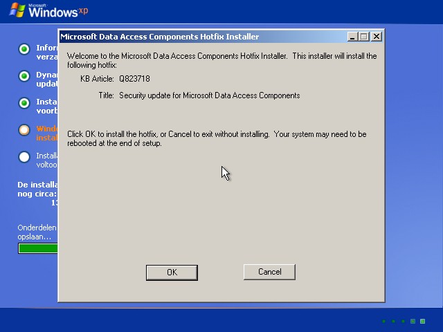

sub0 Posted June 18, 2004 Author Posted June 18, 2004 I have been busy with unattended WINXP and nLite for some days now, being up much too long, school is going bad, etc... edit:1) come all links and files names are in UPPERCASE? Its really Annoying. Can i prevend it? (when copying files from c:\install to c:\Program Files\)edit2:2) I found out 3 updates are not installed (according to windows update), while they should be because i place them in svcpack.inf:Q835732.EXE /Q /O /N /ZQ828026.exe /Q /O /N /Z (windows update says KBxxxx, i named it Qxxxx)Q826939.exe /Q /O /N /Z (windows update says 826939, i named it Q826939)3)edit3:How can i install this one properly:Q823718.exe /Q:A /R:N4) Where can i find: KB832483 (dutch? not in Windows Update)It gave me that window, see attachment.Jesus, so much questions... I numbered them for your convenience
