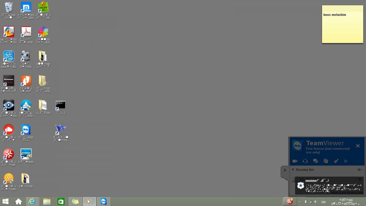

Strange universal font corruption
The user is reporting strange font corruption.
Sure enough, I logged on with TeamViewer and took a screenshot.  Here's what I see:
post-400234-0-93425900-1417392207_thumb.
Anyone know what caused this and how to fix it?
Not having seen that particular corruption I'll make a wild guess and say that something (possibly something the user ran in order to try to change his UI characteristics) messed up the [HKEY_CURRENT_USER\Control Panel\Desktop\WindowMetrics] key contents.

It's probably a font substitution issue (since the taskbar is messed up too.) Try restoring the attached keys.
DefaultAllFontKeys.reg
Edit: If that doesn't work try restoring the font links: HKLM.FontLink.backup.reg
Edit 2: Last resort, http://www.withsteps.com/2621/windows-8-default-font-download-repair-kit.html  :thumbup
