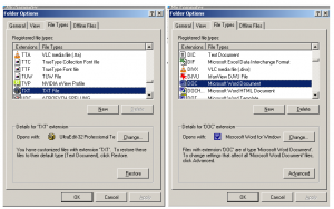

Asp Posted July 24, 2012 Author Posted July 24, 2012 (edited) I'm not sure what you mean here. I don't think there's anything in UURollup which would cause such behaviour. Could you provide some screen shots to show what the problem is exactly about?Well whatever the root cause I thought that problems with extensions would be related.Note that there is no "Advanced" option for txt, unlike doc.I guess that this can be accessed via the Registry, or by 3rd party tools. Edited July 24, 2012 by Asp
tomasz86 Posted July 24, 2012 Posted July 24, 2012 I've just tested it and this is normal system behaviour. It has nothing to do with unofficial updates
Asp Posted July 24, 2012 Author Posted July 24, 2012 I've just tested it and this is normal system behaviour. It has nothing to do with unofficial updates Okay.So it's a Windows "feature" that you can't configure the command lines if you aren't using the default app. I'll look into 3rd party utilities then.
