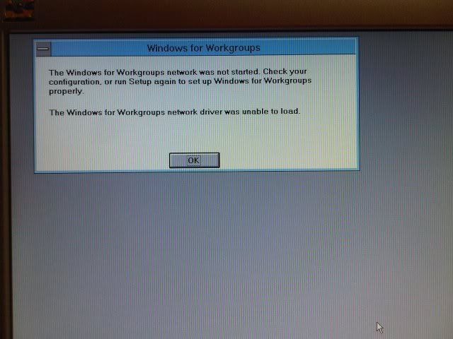

I started messing with win3.11 and installing them under a FAT32 partition with the help of W3XSTART ... all is well but I am unable to make the network work.... :wacko:
I always get the "The windows for workgroups network driver was unable to load" error on windows boot...

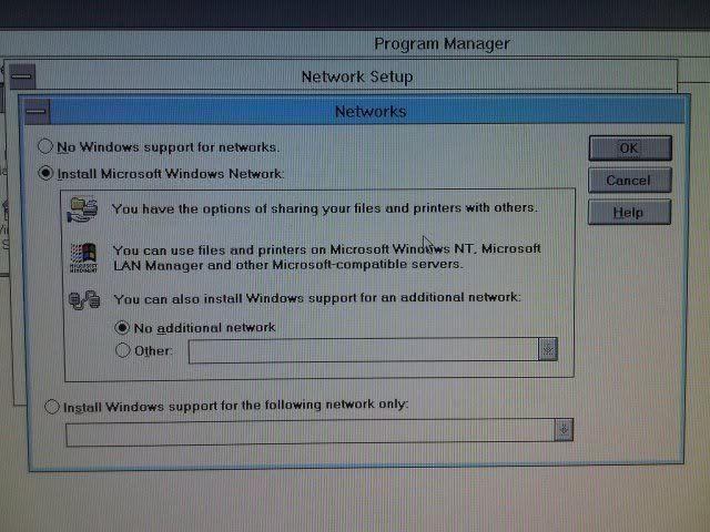

First of all I install the nic driver (a plain 8139D nic)
I get the user/workgroup/computer name screen and username: user311 , workgroup: workgroup (same as win7/xp machines and computer name: win311)

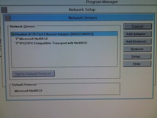

then I check the network settings which seem fine:
and the overall network view:

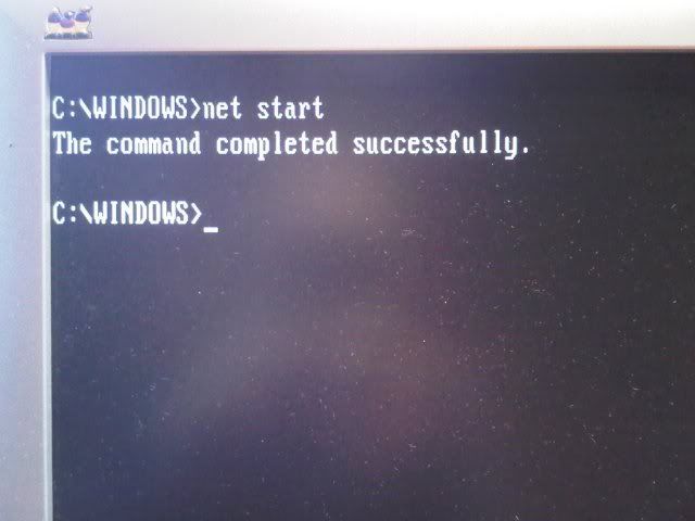

I reboot the pc and since I use a multi-config I just manually type "net start" before windows load:
seems fine but when win311 boots I am always greeted with this:
I have tried the "basic 3.11 network" setting that (to my understanding) switches to NDIS2 driver that loads a paket-like tsr when you type "net start" ... I see the extra info (card name, speed , address etc) but when I start windows this time there are a couple of BSOD's about vxd drivers that are not present and that my windows configuration is invalid. Then I get a smaller message telling me that network is not loaded.

I have found the problem... it was IFSHLP.SYS
I was using the one from win98SE and it loaded fine but it prevented the 3.11 network driver to work
I tried the windows3.11 IFSHLP.SYS and networking worked at once...
