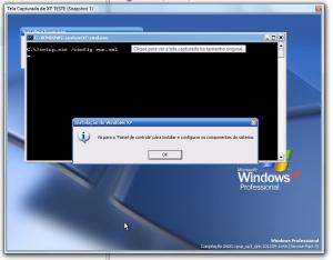

suprasumo74 Posted April 8, 2011 Posted April 8, 2011 Hi folksI'm having the following problem: when I try to install Office 2007 by runonce method the following error occurs: "Go to Control Panel to install and configure system items" (see picture) and installation is simply aborted.I've tried to create SFX files, else install via CAB but the same error occurs. I researched this error message on the net and found nothing.The funny thing is that in the older versions of XP unattended that I created (the last was in October 2010) the installation of office works normally, and I haven't modified anything for the present installation, just inserted the XP updates.Someone knows this error? Well .. take a look at this picture of the error (says in portuguese "Go to Control Panel to install and configure system items". Any ideas? Thanks!

myselfidem Posted April 9, 2011 Posted April 9, 2011 If I see your image, it seems you have already upgraded Windows XP to SP3.Maybe you can find help here about config.xml and RunOnceEx:http://www.msfn.org/board/topic/140068-a-visual-guide-to-7customizer/page__pid__961227__st__20#entry961227 (post #28)Example for Office 2010:http://www.msfn.org/board/topic/143665-how-to-unnatended-office-2010-and-make-it-lite/page__st__40 (post #42)

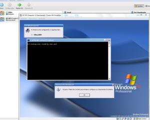

suprasumo74 Posted April 11, 2011 Author Posted April 11, 2011 Hi again myselidem...tks again pal!No solution...i made the changes in config.xml ("pro to "enterprise") as the runoncex (I often do runexxt with avast free but i never tried with office)...so....same error (see the picture)...I'm giving up..i'm thinking is a microsoft kb#@#@ of xp is disording my instalation ( I have 10 other programs included running fine... like nero, powerdvd...)...so...i'll try office 2010 in the next movement..What's make me more bored is when u have a complete xp instalation and than run the SFX file...the office install fine...no erros..again...thanks
