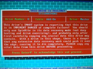

I read much on Spinrite 6.0. to recover data from bad sectors. Bought it and ran it just now. Very scary message! . Attached pic. :(
Should I continue and let it attempt the recovery? Any other solutions or advice.
I have to have this data. :(

If S.M.A.R.T is squawking, it's just a matter of time before the drive will be unusable, you'll continue to pick up bad spots. I've gone through this multiple times this last year(lots of drives spinning here). This is NOT a firmware issue, you've got an actual failing drive there, bad spots will NOT be recovered, they're actual defects, the data that used to be there is GONE. Get a spare of same or larger size, quick, and image what you can off of of it. Then send it in for warranty replacement, if you can. I use DFSee(www.dfsee.com) to do actual drive imaging, there are other products. Bad spots WILL be detected, DFSee will let you bypass them. You'll have to determine which files or file structures they belong to later. If it's a non-system disk, you can use xcopy from the command line with the proper options, you'd have to partition and format the new drive first, though. Xcopy will also ignore errors, pipe the output to a text file to pick up the files with errors later. If you're lucky, the current crop of bad spots will be in files you can replace from backups. For fastest transfer, add the new drive as an additional disk to the MB controller. If the failing drive is already pulled, you can use eSATA or a USB-SATA adapter to do the job. Eventually, you'll get too many bad spots and you won't be able to acces the file system. Then you get to see what can be pulled off using DFSee's data recovery functions. So don't wait too long!
