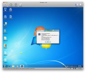

when I do a setup /?
Has anyone used the installdir feature of an msi file?. I have never used it.
See attached picture
