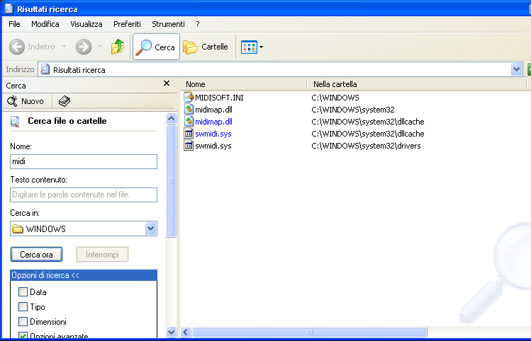

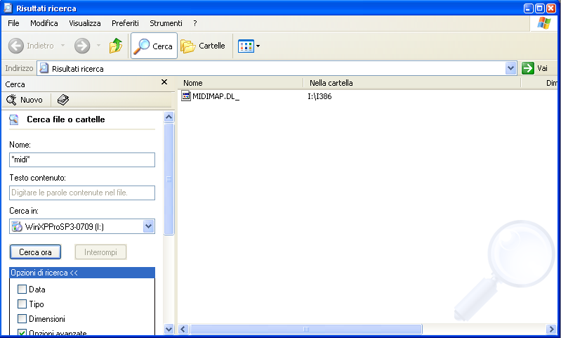

mav Posted July 9, 2010 Author Posted July 9, 2010 ok here are my screenshots: from my running windows: from BOTH my nlited and not-nlited xp cd install yes i hear nothing from any. in the "notes" below there's written: - Nessun file General MIDI DLS specificato nel Registro di sistema. - Risultati del test di DirectMusic: Test riusciti.translation: - no General MIDI DLS file specified in the system registry. (or something like that) - DirectMusic test results: all tests were successful.yes the other audio works on my machine (test in dxdiag on audio tab (not music) is fine). yes i ran nlite multiple times, but the previous ones i only added the update packs and didn't remove anything. i removed components only at the end and all together.
johnhc Posted July 9, 2010 Posted July 9, 2010 (edited) mav, thanks for the screen shots but they confuse me. The one on the running system show the same files as on my system but you show none of the files in either the original CD or the nLited one. Where did the files come from - beats me? The idea of searching for *midi* was just a guess by me and may be a bad one. Since your running system has all these files, perhaps they have nothing to do with your problem. One thought I have is to use another application for midi files. A quick Google search turned up many including this free one. You might try this or another one you find. You can at least remove them via Add/Remove if they don't help. I would suggest that you create a System Restore point before installing them. I did notice that you searched for *midi* in one case and midi in the other. Try both again and with both search arguments and if you get different results, please post a screen shot. Enjoy, John.EDIT: If the file midisoft.ini is not too large, please attach it. Thanks. Edited July 9, 2010 by johnhc
