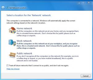

clivebuckwheat Posted July 2, 2010 Author Posted July 2, 2010 Would you happen to know how to get rid of this, every time a machine is sysprepped even if I specify work in my sysprep.xml file it shows up.
cluberti Posted July 2, 2010 Posted July 2, 2010 Clive, this has been discussed before. Don't forget that you can try a search before posting a question just in case; we've got 9 years of history to search through .
