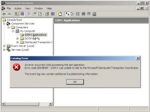

Just when I thought that the problem was solved. Looks like part of the problem probably is still there and the ghost is back to haunt me :} I followed the steps above (posted by allen2) and got the error shown in the attached image. I then checked Event Viewer and it has 32 entries similar to the one below

Just when I thought that the problem was solved. Looks like part of the problem probably is still there and the ghost is back to haunt me :} I followed the steps above (posted by allen2) and got the error shown in the attached image. I then checked Event Viewer and it has 32 entries similar to the one below...
The problem is, the problem was never really gone. MSDTC is a demand-start service, so you will only see errors from it when something in COM requires it - which likely explains why it was "gone" for awhile, and then started showing up again later. What allen2 had you do just masked the logfile problem (although it did cause MSDTC to spit out more useful errors, so it was a good effort to do nonetheless). However, at this point MSDTC is still broken, so the errors (and any problems using MSDTC) are going to come back as soon as the logs are rebuilt the next time MSDTC is started. What I suggest is not removing the symptoms by sweeping the errors under the rug, but actually doing the cleaning necessary to *fix* the problem. Otherwise you still have dirt on the floor, you just won't see it for awhile - that's not fixing anything ;). To that end, and to explain what is wrong:
What you have are two different, but related, event errors - the first and third error in the event log are actually the same, specifically it is logging that your machine is failing to start the MSDTC service because something in it's init is failing. The second event is specifically why the MSDTC service won't start - 0x8004d027 == XACT_E_UNABLE_TO_READ_DTC_CONFIG. What you're likely to see if you open dcomcnfg at this point is that the My Computer icon under Component Services will have a red downward pointing arrow icon indicating a problem with both the COM+ catalog on the machine, as well as the MSDTC configuration. You are going to need to remove and re-add the MSDTC components at this point, and also rebuild the COM+ catalog to get back to a working, clean state (it's likely some COM object was installed that broke this at the root of the problem, although tracking it down now is not possible).
1. In services.msc, you need to stop any service that is running that the system will let you stop (just don't try to stop the Remote Procedure Call (RPC) service, or you'll reboot the box) - doing this is important, as MSDTC removal/reinstall can fail if services are running and locking files.
2. Open a command prompt logged on as an Administrator, and execute the following command:
msdtc -uninstall

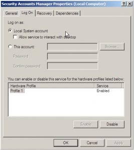

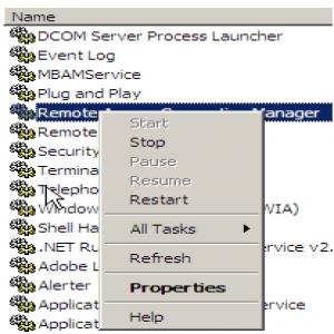

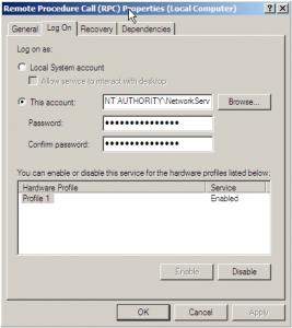

Hi cluberti,
Well after posting my earlier reply, I decided to give your solution a try BUT could not get past Step #1 (quoted above) because no mater what I tried, I just could not stop the services shown in the attached image. It was a pain to manually stop the services one by one. Is there a tool to
1. Issue 1 command and stop all services. I found a tool called Seriwin but that did not work
2. Is there some trick to forcefully stop services like the one's shown in the attached image?
What else information can I provide? Okay I took screenshots of the services that I was unable to stop and these are the things i noted:
1. ONLY Remote Procedure Call (RPC) service had a Logon Tab different than the others. The logon Tab of Remote Procedure Call (RPC) service and just 1 of the all others is also attached. Is this normal or ??
2. Only Remote Access Connection Manager and Telephony services offered the Stop option. (Pls see attached image)
3. But both services mentioned in point above took more than a minute each and just towards the end gave the messages shown in the attached image
Please let me now if you need any more information.
So what do i do now?
Thanks.
You may actually be having an issue stopping services because of the COM+ problems, and this is ok. It's why my step#1 said "you need to stop any service that is running that the system will let you stop" rather than just "you need to stop any service that is running". Do what you can, and miss what you can't. Still keep trying, as technically this step is only a precaution, rather than a requirement. If you really get stuck and services do cause msdtc -install to fail, you can try in safe mode. However, it *should* work from regular mode, even with most services running. Give it a try, see what happens :).

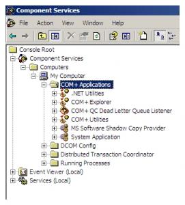

1) The 1st attached image shows how the COM+ things looks like now. DO you think the problem is resolved?

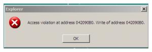

2)I however have been getting the error shown in the 2nd image (Explorer Error.jpg) every now and then. Sometimes when I close Windows Explorer, a error dialog saying "Invalid Pointer Operation" also pops up. Any suggestions on how to get rid of these? Please.

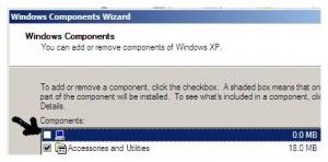

3) Last but not least, and something that worries me the most, is the entry shown in the 3rd Image (Maybe some Hidden Nasty.jpg). Is this something normal or is the problem still there :(
Depends on how the event logs look, but according to that screenshot MSDTC is working again, so that's good news.
Assuming you don't get this any other time, you probably have an Explorer shell extension that's COM object is broken due to what was done previously, although it'll be hard to give you a culprit pinpointed without a dump of explorer crashing out. It might be easier for you to use ShellExView and disable anything non-Microsoft, and play the roulette enable/test game to see if you can pinpoint the exact one that's failing (it'll probably work fine once you disable anything non-Microsoft).
I don't see a third image, so I can't state anything about it. However, I would suggest doing something a little drastic (sort of) - if you had to restore COM components from an old backup image, you probably now have mixed versions of files. It would be best to reinstall whatever SP you have (I'm assuming XP SP3) and then use MBSA 2.1.1 to find out which hotfixes you need to reinstall after that.
Sorry. Forgot to attach the 3rd image. It's attached now.
Thanks for the clue about using ShellExView. I'll try it :)
