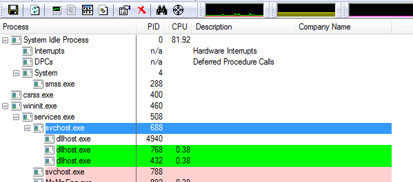

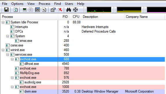

PC_LOAD_LETTER Posted January 9, 2010 Posted January 9, 2010 well not exactly nothing but Computer management doesnt openUsing Process Explorer i can see dllhost.exe opening 2x under svchost for DComLaunchbefore:during:I can still open MMC and load compmgmt.msc and evertything worksWindows 7 Professional x86, UAC at defaults, clean installed 2 days ago
