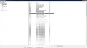

AtillaMaximum Posted August 28, 2011 Posted August 28, 2011 Hello,I have been trying to track down an issue where loading webpages is causing stuttering in any auido that is playing, be it a media player or simply a youtube video playing on another window. Happens with IE8, Firefox, and chrome. Process Explorer shows "Interrupts" spike near 100% cpu usage when a link is clicked. Used Xperf per the guide and the table shows ndisinterrruptDpc count vastly above anything else. I updated my drivers with no change. I was checking over IRQs and notice that my nic shares IRQ17 with 2 USB host controllers and a pci-to-pci bridge if that might be an issue. Attaching XPerf table and IRQ sys info. Any advise of what I should try from here would be appreciated.Vista Ultimate SP2 X64AMD Phenom II X4 965 @ 3.8Ghz stable8.00 GB ramMSI motherboard, don't have model#Realtek PCIe GBE Family ControllerRealtek High Definition audio device
MagicAndre1981 Posted August 28, 2011 Author Posted August 28, 2011 what is your connection speed? Your realtek chip doesn't have its own interrupt handling and the CPU must handle this. The faster you download, the more CPU usage you have.@hottrochave you checked the IRQ sharing?
AtillaMaximum Posted August 28, 2011 Posted August 28, 2011 (edited) I have 18 Mbps cable internet, though I notice that right after a restart it won't do it. Only after its been on for 20-30 minutes.If I went to purchase a nic card how will I know if it has interrupt capability?EditActually its a bit faster according to the test:http://www.speedtest.net/result/1454906788.pngIt does seem that it got worse with the speed upgrade, previously I had 6Mbps and it was not as bad.Also, it only happens with web surfing, not FTP, torrent, games or http downloads. Edited August 28, 2011 by AtillaMaximum
