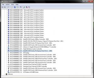

Fallen Posted March 22, 2011 Posted March 22, 2011 (edited) OH MY GOD, It doesn't say UNKNOWN anymore, maybe because i reinstalled win7 x64 yesterday.It says that high cpu load at interrupts is caused by USBPORT.SYS. (USBPORT_InterruptService)I'll post the .etl anyway.http://www.mediafire.com/?agl3rdabd987k9dNow... my motherboard si Asus P5K SE.I have 12 USB Ports (MAX), 6 on the back panel and 2 connected (the others are not connected) in the front of the case.At the back panel, only keyboard + mouse are connected.Keyboard: Microsoft ReclusaMouse: Razer CopperheadSo, the only 2 usb ports used are those 2.LE: I disconnected my keyboard + mouse from the pc + disconnected the frontal case usb, and i still got the interrupts. I don't know what to do, if usbport.sys was related to usb connected devices.\LE2: I just saw something strange at my device manager -> view -> resources by type -> interrupts.http://img220.imageshack.us/f/pastedimagev.jpg/LE3: I tried to connect a PS/2 Keyboard to the PS/2 port on my mobo, and the keyboard doesn't work. Instead, all the leds from num/caps/scroll lock are turning on and off at the same time. WTF Edited March 22, 2011 by Fallen

Fallen Posted March 23, 2011 Posted March 23, 2011 (edited) Of course it happens if i close steam.I disabled usb wakeup from the mobo jumpers right now. And by enabling my front usb again, i connected my keyboard and mouse there, so backplate usbs are empty.I still got the interrupts. I really don't know what to do, but i'm sure it's somehow related to that error on PS/2 Keyboard. Maybe my port is broken, but i can't disable it from bios. Or maybe some devices are sharing the same IRQ.Look at the screenshot i attached.My Soundcard, my lan card and my onboard sound card are sharing the same IRQ (17), is that right? or i don't know how to read \Same with IRQ (16) PCI Express Root Port 6 + USB Universal Host Controller.I don't know...Ok, i tried something else. I tried to disable every USB related line from device manager with process explorer on the screen, so that it will show me realtime when the interrupts dissapear.If i disable my Intel® ICH9 Family USB Universal Host Controller - 2937 the hardware interrupts dissapear. If i enable it, they reapear. The strange thing is that the usb ports are running ok if they're enabled.Ok, let's say the problem is solved.. i have found out who is responsable for this. I even know what usb ports are stopped when i disable the usb 2937, but what now? How can i disable this from windows?Later EDIT: YES. I know!!! It is related to the attachment i just posted. If you look at the attachment, Intel® ICH9 Family USB Universal Host Controller - 2937 has the same IRQ as the PCI Express.If i disable Intel® ICH9 Family USB Universal Host Controller - 2937 from device manager, Intel® ICH9 Family USB Universal Host Controller - 2937 dissapears from Interrupt Request TAB (attachment) and i have no more interrupts.Now, i must figure a way to change IRQ for usb or for PCI Port.Any ideeas? Edited March 23, 2011 by Fallen
MagicAndre1981 Posted March 23, 2011 Author Posted March 23, 2011 Now, i must figure a way to change IRQ for usb or for PCI Port.Any ideeas?this can't be done in Windows. Check if that it can be done in the BIOS.
