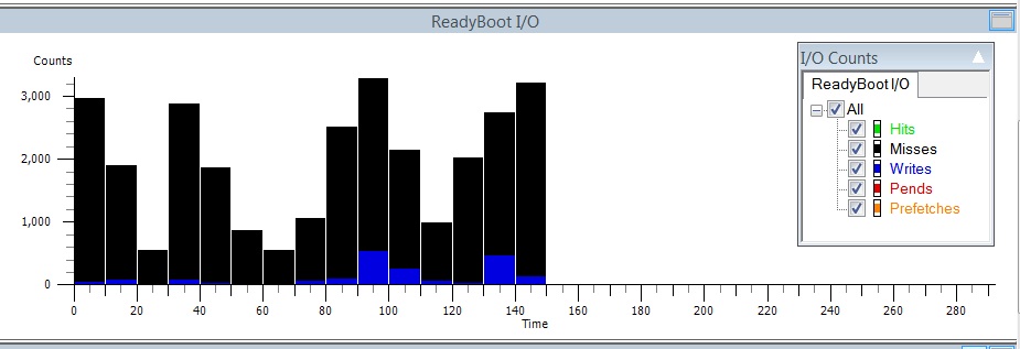

geekster51 Posted March 6, 2012 Posted March 6, 2012 (edited) compress it as 7z (ULTRA compression ratio, LZMA2 compression type)I downloaded and installed 7-zip.Compressed my ETL file using ultra compression and LZMA2 type. Compressed file is 8.41 MB, but my global upload quota here on MSFN is only 500 KB ... so I cannot attach the 7z file. Is there any way for me to increase my upload quota here?In the mean time, I looked at the ETL file using xperf and noticed that the ReadyBoot I/O chart has a large number of cache misses. I took a screen shot of that chart and attached it.Until I can increase my upload quota, if you wish, I can take screen shots of any other charts you need to see and attach them.Seems to me that ReadyBoot is not caching ... and if it did, my boot time would be significantly reduced. But (other than reinstalling Windows) I am not sure how to get ReadyBoot to start caching again (prior to January 27, ReadyBoot was caching). Edited March 6, 2012 by geekster51
MagicAndre1981 Posted March 6, 2012 Author Posted March 6, 2012 yes, ReadyBoot is really broken.I have never does this, but move the files from C:\Windows\Prefetch\ReadyBoot to a different folder and reboot. Does ReadyBoot create new files? Can you now run the optimization?

geekster51 Posted March 7, 2012 Posted March 7, 2012 PROBLEM SOLVED !!!!!!!!!!!!!!GroftLuigi:Thanks for the suggestion ... I started the Performance Monitor, and verified that the ReadyBoot task was still enabled.Andre:Thanks for your help.We both thought of the same thing. I went for a walk to think about this problem ... and concluded that the reason ReadyBoot was unable to cache was that it was unable to access its cache folder. When I got home, I checked the date stamps on the files in the c:\windows\prefetch\readyboot folder and found all the dates were January 26 (i.e., the last date when the ReadyBoot cache worked).Then, I saw your latest post in this thread suggesting that I move the ReadyBoot folder. Instead, I just renamed the ReadyBoot folder and rebooted. The boot was a bit faster, and the Result Code in the Event Log for ReadyBoot's boot plan calculation was no longer 0x6F ... instead the Result Code was 0 .... a very good sign that the cache was being used again.I rebooted again, and my boot time went from 150 seconds to 51 seconds !!!!!! As I continue to reboot and the ReadyBoot cache gets refined, I'm hoping that my boot time decreases a bit more. But this problem is solved! I am guessing that the problem might have had something to do with folder permissions (ReadyBoot may have lost permission to access the folder/file used to build its boot plan, but I cannot verify that. If we had been able to clearly determine what the 0x6F Result Code meant ... my guess is that it may have indicated that ReadyBoot could not access its designated folder/file). Lessons that I learned: Window 7's ReadyBoot feature really does reduce boot time. If that feature is broken, then ones boot time can easily double.To verify that ReadyBoot is working ok ... look in the Event Viewer > Application and Services Logs > Microsoft > Windows > ReadyBoost > Operational for Event IDs 1016 and 1015. These events will occur shortly after the previous boot.The 1016 record should look like this (and shows that the Boot plan calculation, which determines the files to be cached for booting, returned a zero Result Code): Boot plan calculation completed in 2449 ms. Boot Plan Timestamp: 2012-03-06T19:28:12.885313600Z Reason: System boot completion Result: 0x0The 1015 record should look like this (and shows the Cache Hits for the previous boot). The Cache Hit numbers should not be zero (which would indicate that ReadyBoot's caching is not working).Summary of ReadyBoot Performance: Io Read Count: 34728 Io Read Bytes: 745637888 Cache Hit Count: 22178 Cache Hit Bytes: 382853632 Cache Hit Percentage: 0.638620133609767 Boot Prefetch Time (us): 40325470 Boot Prefetch Bytes: 407842816 Boot Prefetch Read Count: 11033One last comment .... Microsoft (in its infinite wisdom) has implemented two features with very similar names: ReadyBoot and ReadyBoost. ReadyBoot – decreases boot time (the time from turning power on to reaching the log-on screen) by preloading the files and startup programs needed per-machine into a cache.ReadyBoost – supports the use of flash storage devices like Universal Serial Bus (USB) flash drives and Secure Digital (SD) flash cards to boost PC performance. Unfortunately, the Events record for ReadyBoot are found in the ReadyBoost Event Log .... this can be confusing.
