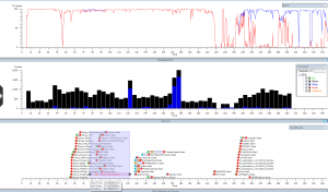

MagicAndre1981 Posted September 24, 2011 Author Posted September 24, 2011 The resume of the nVIDIA driver takes 3 seconds which is a bit long. Try the 285.27 instead of the 280.26.It seams you use the Hybrid Sleep which write the data also in the hiberfile.sys. And reading the data takes 7.4s to read the data.

MagicAndre1981 Posted September 25, 2011 Author Posted September 25, 2011 Done. http://www.mediafire.com/?d3ytmvnc96tbns0Password via PM.Your boot prefetcher (ReadyBoot) is completely broken and doesn't work the way the prefetcher should. This casues the HDD to be busy all the time:Install the hotfixes from here:http://www.msfn.org/board/index.php?showtopic=152622and optimize the Prefetcher:http://www.msfn.org/board/index.php?showtopic=140262The only difference was when the computer hung on resume, resetting caused a hard reboot rather than a Windows resume. I was unable to get a good trace with this configuration so I turned hybrid sleep back on and got a new trace. It also hangs and I have to reset to get a Windows resume. That's how Hybrid sleep works. If something happens during standby Windows doesn't loose data it resumes from the hibernation file. When I tried to convert it to an .xml file, I got an error message which read "xperf: error: /tti: does not expect 1 argument(s)."https://skydrive.live.com/?cid=0d8f89132a995684#!/?cid=0d8f89132a995684&sc=documents&uc=1&id=D8F89132A995684%21325Gregthis is the complete command: to get the overview XML:xperf -i standby_BASE+CSWITCH+DRIVERS+POWER_1.etl -o summary_standby.xml -a suspendThis time the following USb device takes 5s to wake up and resume:- <resumedevices start="163018123" duration="5922378">- <device start="163582798" duration="4157050" name="USB\VID_04A9&PID_107F\101HJL">From what I see this is USB Printing Support. So try to disconnect your Canon Inkjet i860 before resuming Windows and it takes 11s to read the hibernation file:hiberread="11470000" But I can't see why it takes so long before you forced the reboot.Here you must run Process Monitor, start the logging and next run the xbootmgr command to start tracing and this don't reboot. Wait several minutes. I had an issue with my PC where hibernation takes 10minutes to resume. Which the ProcMon log I was able to solve it.

MagicAndre1981 Posted September 25, 2011 Author Posted September 25, 2011 Run the xboot comand in C:\Temp where you stored the data.ProcMon is easy. Configure it to log the data into a file (not the pagefile), start the logging, next run the xbootmgr command. After you resumed, run ProcMon again and stop the logging. Now look at the duration column what takes so long. For me it was reading the MFT and hibernationfile, so I defragged the $MFT and the hibernation file and the issue was gone. I only saw this with ProcMon. the XML told be a driver was slow to resume, but it was the HDD.

MagicAndre1981 Posted September 25, 2011 Author Posted September 25, 2011 ok, I only see that the service was running so I thought it was set to automatic.I highlighted Avast in the first trace. Look how long Avast takes this time to start.
