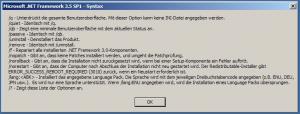

HØLLØW Posted August 12, 2009 Posted August 12, 2009 I'm sorry that it is in german, but you can see the switches of the .NET Framework which can be used.
