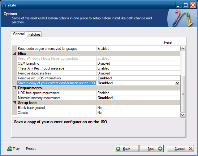

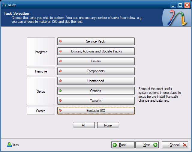

Select "Options" under "Task Selection"...
...then Disable "Save a copy of your current configuration on the ISO" under Misc.
Simple. ;)

I meant the last session INI files that are saved onto the disk.
@5eraph
Thank you! That's exactly what I was looking for.
