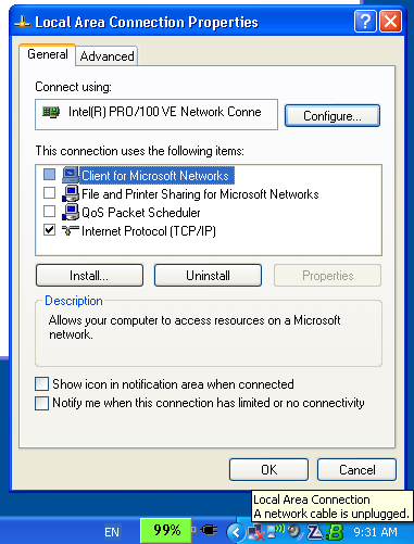

Geej Posted December 23, 2008 Posted December 23, 2008 In Control Panel, Network Connection, right-click on your connection to access it's connection properties.At the bottom of it, u can tick your option.[ ]Show icon in notification area when connected[*] Notify me when this connection has limited or no connectivity (Default is checked)

Geej Posted December 29, 2008 Posted December 29, 2008 (edited) Thanks, but didn't work. I deselected both options, rebooted, but the icon comes back regardless. Try item 394: Remove/Restore Network Icon - System Trayorsee post 20 whether this can help.orU can also check your registry key whether the key setting actual stick after change. In a test Xp m/c, my LAN is[HKEY_LOCAL_MACHINE\SYSTEM\ControlSet001\Control\Network\{4D36E972-E325-11CE-BFC1-08002BE10318}\{4F452355-4358-4011-957F-524C952167EE}\Connection]"PnpInstanceID"="PCI\\VEN_14E4&DEV_167A&SUBSYS_3029103C&REV_02\\4&39BFA70D&0&0030""MediaSubType"=dword:00000001"Name"="Local Area Connection""ShowIcon"=dword:00000000"IpCheckingEnabled"=dword:00000000(Do a text search within the registry: Local Area Connection)Check ShowIcon & IpCheckingEnabled actually stay at dword value : dword:00000000 (ie disabled after reboot)I think u need administrative right to keep the setting as is is in HKLM, assuming u made changes as limited user.I see 99% tray info icon. Possible this program is causing normal logic operation. (U can try uninstall first and see whether network icon still shows)Hope that helps Edited December 29, 2008 by Geej
