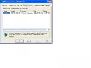

sobase Posted August 12, 2008 Author Posted August 12, 2008 I believe that x64 SP2 already contains MDAC 2.8 SP2. You can run odbcad32.exe from a command prompt to see the x64 components (open a 32bit command prompt and run the command there to see the 32bit components).Cluberti,I ran the command, there is no ODBC driver available there apart for SQL Server. Please see the attachment.Our tool try to connect to ORACLE database through ADODB using MSDAORA.1 provider, has it anything to do with ODBC or just MDAC?Please advice and thank for the help in advance.Regards,Sobase

sobase Posted August 12, 2008 Author Posted August 12, 2008 If I run the commands (odbcad32.exe) under c:\windows\sysWow64, then I can see more driver in the ODBC admin window.I guess I need to redirect to which ODBC my tool should use. But anybody know how to do this?
cluberti Posted August 12, 2008 Posted August 12, 2008 If I run the commands (odbcad32.exe) under c:\windows\sysWow64, then I can see more driver in the ODBC admin window.I guess I need to redirect to which ODBC my tool should use. But anybody know how to do this?If your tool is 64bit it'll use the 64bit odbc components, and if it's 32bit it'll use the 32bit components. As you can see, there are far more 32bit than 64bit components.
