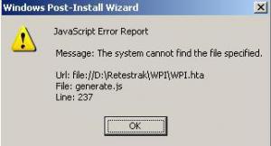

  3. Update: It seems that the only way to address this issue is to turn audio off completely during the program(s) installation. So far so good but the priority part still messes up, i'll look at other people's post to figure out how they fixed that. Thanks for all the help!
