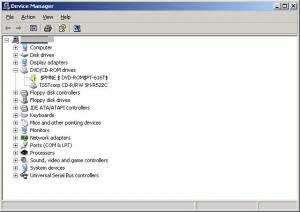

On primary-Master -> Hard Disk Primary slave-> Empty (Will try this solution) Configured jumper to Secondary-master(instead of CS). (Cable is though 40 conductor IDE) But still the problem remains. Read: Its an old drive, out of blue one day this problem arose. Agreed jaclaz, But no one in forum is reading completely my post/problem scenario.: 1. After upgrading my Ram from 256MB to 1GB, and 3 days after this problem arises. And Windows-XP BSOD which use to crash several times in a day, now it crashes once in 2 days. [Note: I now replaced with my Old RAM, but the problem remains). So i think new RAM is fine and in good health. 2. I tried all permutuation+combinations of configuration(including new cable change), The point is DVD drives now only works when i disconnect my cd-writer (on Secondary-Slave). PLEASE SOMEONE HELP ME sort out point number 2 above, why this is so? I think (probably), there is some point of voltage(power) problem between, something and DVD Drive. If that is, how do i find this problem (Before buying a new drive). I may be on wrong path, but will definitely try the above solution (putting dvd drive on Primary-slave). But my drive before RAM-Upgrade was working perfectly for 3 years, out of blue one day i was into this problem. Thanks jaclaz. Will reply soon, if it works or not.
No, changed with a new PATA cable (with CS jumper set), still the problem remains. My DVD is on Secondary-MASTER (with CS selected) and CD-Writer on Secondary-SLAVE. Now, what i did was, i disconnected my CD-Writable power cable, and then It was all fine and the problem solved. That means with 1Gb of RAM i can connect only 1 optical drive at a time. Otherwise the problem remains, and what i also noted is the DVD-Drive changes from: PINE DVD-ROM PT-616T to PINE $ DVD-ROM PT-616T$ and then again to PINE $ DVD-ROM PT-616T i.e., $ keeps on adding to correct device (DVD-Drive) identifier. Now, what i m thinking is whether my system can afford that much power(Voltage) (my motherborad is i845)? Since disconnecting RAM is very difficult in the box, i will try removing or changing SDRAM (downgrading to 512mb) next time and tell u the result. For time being, please post more valuable tips to solve the problem.
really bad luck of mine, i re-opened my cpu box, re-connected data cable of DVD-Drive to motherboard, and then started my windows, now the Drive is not even showing in Windows Hardware. I am worrying, what could be the problem. All this is happening when i installed 1gb ram from 256MB. I dont know wther my motherborad(i845) is getting appropriate voltage to handle 1gb ram? and worrying whether in future my cd-write wont get damage by all these. Nice try and help, geek. I need to clarify what do u mean by: 1. "........... I know you wont be able to fix that with a driver update." Do u mean firmware instead of driver update? 2. "the firmware on your cd drive may be just fine but somehow incompatible with your particular hardware combination" Earlier the drive was working fine for past 2 years in same computer/cpu-box. OR do u meand DVD-drive could handle the load of 1gb ram, (its funny to say so ) Will keep this topic updated on my finding. Thanks all.
no, its not samsung. But full Product name is: PINE DVD-ROM Drive 16x Model PT-616TEB It came pre-installed with IBM-Netvist Machine. 1. Can u tell me what caused the firmware to damge/corrupt? Can u share some information regarding firmware corruption and any links useful for me. 2. U recommend me to install samsung firmware on This pine dvd-drive? (When i opened the CPU-case, on top of drive, its said the above model number, and in small letters it says Manufatured by Samsung)- I am not sure if i may corrupt the firmware making drive permanently unuseful. (Though it still is unuseful as of now, but still hope is there) Thanks for support and information.
yes, will test the RAM from memtest86. Regarding DVD, It is not the Drive letter but DRIVE NAME that gets changed. Its not a windows problem but i think a hardware one, as BIOS also shows these gibberish characters. waiting for reply...
Recently, i upgraded my SDRAM from 256MB(128*2) to 1GB (512*2), and after few days changed by Motherboard battery. Now i am facing these problem: 1. Occasionally, windows xp restarts in middle withought giving any warning. For past 2/3 days it has stop doing so. I didnt know why was it happening, using crash-dump analysis, i found some sys files crashing. (But found no apparent reason). Now the major problem which occured: 2. My DVD drive name changes (gibberish or bad characters with $ character) on every boot in BIOS and thus i cannot use this drive in windows xp. (Since windows xp dont recognise this drive). In BIOS, i tried using auto-detect several times, but found no solution. Windows xp worked perfectly correct for 2/3 days after i changed battery. I am confused. What could be the problem? has someone faced such thing? Please help me find the solution or guide me in correct direction. p.s. attached is the image of Device-Manager
