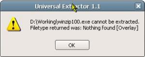

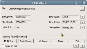

  2. I verified at work and it happens definitely with the new version 1.1 as you can see on the screenshot. I'm verifying what could be the difference between home and work. Here at work nothing special is installed. As you can see on the second screenshot the message "Nothing found [Overlay] is delivered from PEid.exe. I will report if I find something. Saluti

  4. Seems that sometimes it has difficulties to recognize the archive format. If you take for example the original Trialversion for winzip 10 - a zipexe archive - UniversalExtracter responds with a message: winzip100.exe cannot be extracted. Filetype returned was: Nothing found [Overlay] If you try to extract it with Winrar or 7-zip there are no problems. This problem existed since the first version of Universalextractor Saluti
