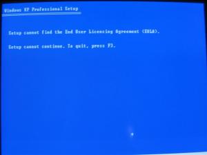

  3. Now That I Resolved My BootLoader Issues And I Can Boot Into My Setup Files, Im Getting The Error Cannot Find License Agreement EULA Press F3 To Reboot. Can Anybody Tell Me What I Need To Change To Point My Setups To This File. It Happens With XP And 2000 Boot Files. Thanks I Will Also Upload A Pic Of My Error Screen. NateDawg1169
  4. Alright Guys You Can Close This Thread With The Help Of Liquid Sage I Found Out My Problem Was Just My Version Of Cd Shell. I Was Using 2.1.6 Which Gave Me The Boot Error. As Soon As I Switched To 2.0.11 My Dvd Worked Fine. Thanx For The Help LS NateDawg

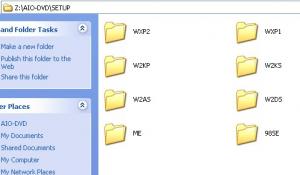

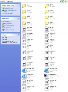

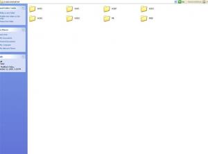

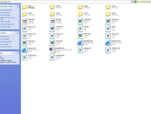

  7. Thanks for the quick reply, Ive gone through the items you mentioned you know Im not possitive because this is new to me, and I could have missed something, but that being said I pretty confident I didn't make any editing mistakes. As far as corupt files I dont know Ive tried 2 different versions of cdshell the one I downloaded from this site and one I downloaded directly from cdshell.org. Im not testing it in a virtual machine, just a pain in the a** for me to play around with, Ive ran some in the past and it has a tendency to crash my pc. Im just skipping straight to the field test. The only thing I checked was my menu was working with the chshw debugging command. Ive included screen shots of my setup and root folders to give you an idea of my naming schemes for my folders. Also included the loaders from my boot folder and all my dats. If you would like to investigate further. Thanks man i appreciate your help Loaders_N_Dats.zip
