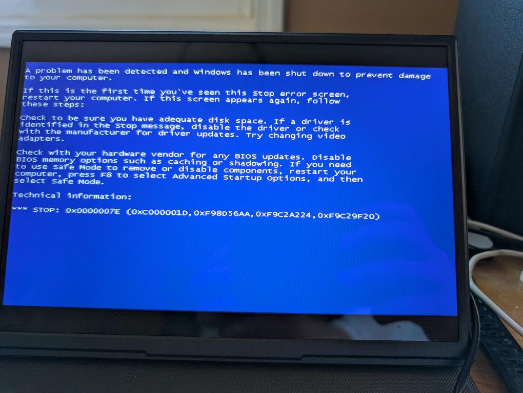

  3. Digging into it further, the 0x0000007E STOP code means SYSTEM_THREAD_EXCEPTION_NOT_HANDLED. Parameter 1, 0xC000001D, means STATUS_ILLEGAL_INSTRUCTION. According to https://learn.microsoft.com/en-us/openspecs/windows_protocols/ms-erref/596a1078-e883-4972-9bbc-49e60bebca55 So there's an opcode the 486 doesn't like getting executed somewhere. @Dietmar I hate to bother you again, but do you know what I should do to find what module is executing an illegal opcode? If I start it in safe mode, it goes further and actually initializes graphical mode for a few moments but then I get another illegal instruction crash in KSecDD.sys but I don't know if this is the same module that is causing a blue screen when booting in normal mode.

  6. The text installer finished, but it won't boot into the second graphical part of setup. I get a blue screen with stop code 0x0000007E and first parameter 0xC000001D Is this because I haven't copied ntoskrnl.exe to the hard disk from the CD? I didn't have to do this when I tested in 86Box. Do I need to run the expand command on ntoskrnl.ex_ from the CD, or is there an already uncompressed patched version that I need to copy? EDIT: The ntoskrnl.exe on the hard disk already has a date stamp of April 29, 2024 so it would seem to already be the patched version. So I'm not sure what causes the blue screen.

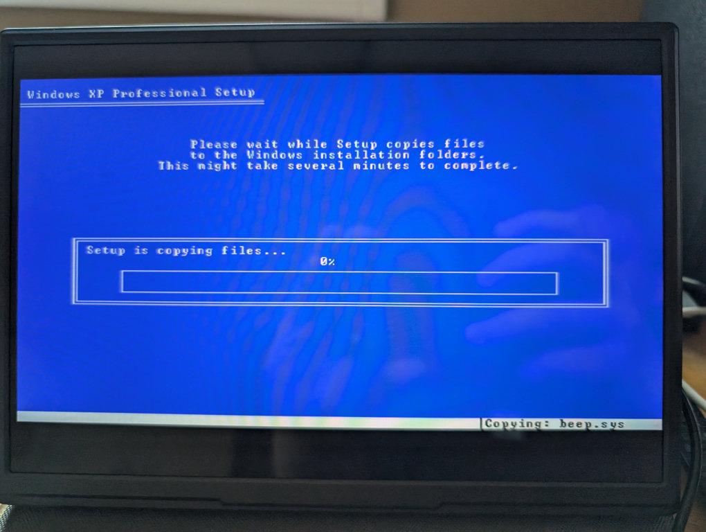

  8. I can't explain this at all, but I just put the hard disk in as SECONDARY master with CD-ROM as secondary slave and now it works! I would say something is wrong with my primary IDE controller, but it works with Windows 2000 so I don't know what's going on. I don't mind leaving it as secondary master, but what a strange problem this is! Anyway, it no longer gives me the error and I created a partition and formatted as NTFS. Now the text-based installer is copying files to the hard disk. I will edit this post later to say whether it worked completely and lets me boot into XP.

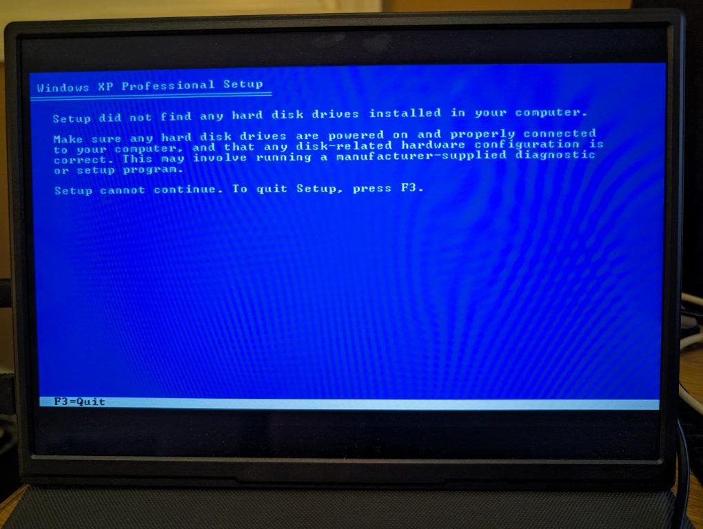

  10. It is recognized in the BIOS and it works with Windows 2000, but not XP. EDIT: I have been trying the English ISO. I will try the German version. Früher konnte ich ein bisschen Deutsch. Das meiste habe ich vergessen. EDIT 2: The German ISO gives the same error unfortunately. I'm not sure what's wrong. You didn't need to load special drivers for the UMC8886 IDE controller?
  11. Thanks, I'm already using the 2001 Award BIOS and I have tried a 10 GB and 15 GB mechanical IDE drive, both jumpered as master on primary IDE channel. Do you have your CD-ROM on the same channel as the hard disk? I have been using hard disk on primary master and CD-ROM on secondary master. My boot order is CDROM, C.
  12. Sigh. Another issue. "Setup did not find any hard disk drives installed in your computer" no matter what known good drive I install. Windows 2000 did not have this problem, it installs and runs fine. This is a Shuttle HOT 433 rev 1-3. @Dietmar isn't this the same board you're using? Did you have to do anything special to get Windows setup to see your hard drives? I'm using the Award 2001 BIOS.

  14. The text-based installer doesn't work, this is the issue. It loads some drivers from the CD, but then crashes as it starts the Windows kernel.
