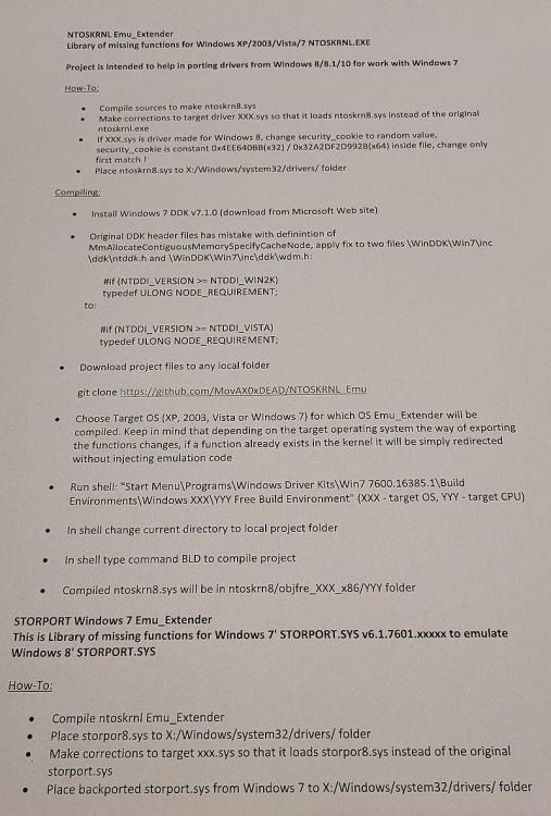

  4. My first attempt to compile the NTOSKRNL_Emu code, giving up is not an option for progress. https://youtu.be/cFAR923LUzo

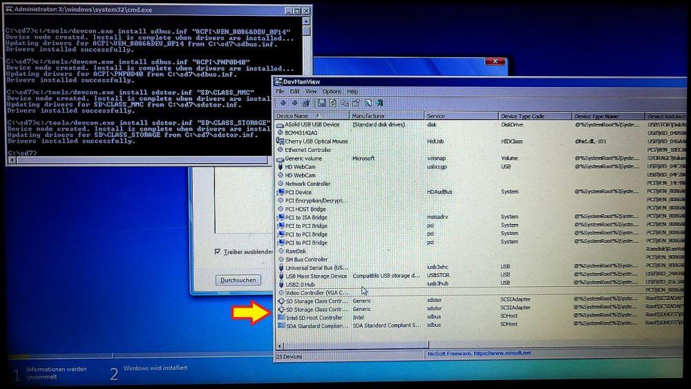

  7. Hi! I've been working with the BayTrail ChipSet and Windows 7 x64 (GPT/EFI) again recently (VEN_8086&DEV_0F14 - emmc / VEN_8086&DEV_0F16 - sdcard). As far as I can see, the chipset was first included in the drivers with Windows 8.1. The packages provided here could not be regularly installed on the device. I made the most recent attempts in the CMD with DEVCON.EXE. I copied the .SYS files to the System32 directory in advance and deactivated the driver signing check when Windows started. This way the drivers could be loaded, but no function could be determined. I am currently searching the Beta8.1 versions for the first signs of BayTrail support. Best wishes and a happy new year.
