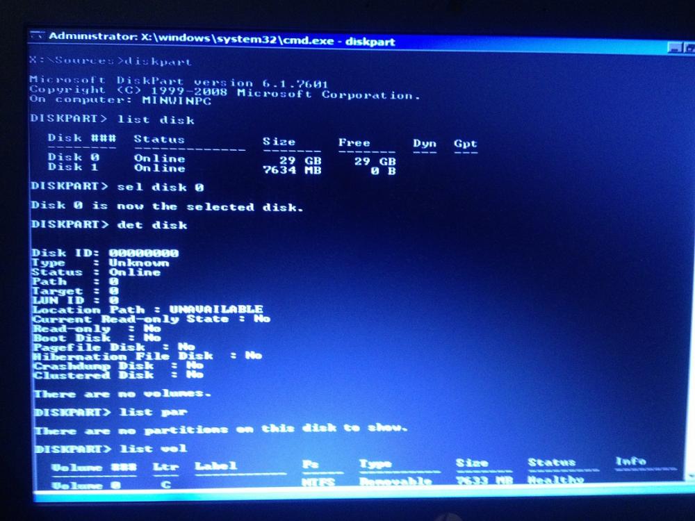

  16. Yes I am on win 8.1. You mean apply Windows 7 install.wim onto my emmc drive? I think that's too risky atm since the win7 setup isn't detecting it properly (see screenshot above). Win7 diskpart is detecting it as type: Unknown

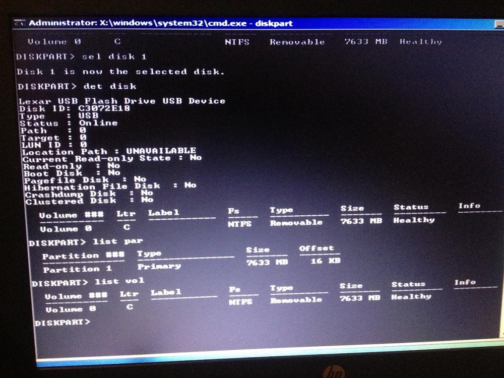

  22. Ok, so I tried these steps with the lexar and the apply-image was taking too long. Next I tried with wd elements all the steps went smoothly (I think). I used the 'cd' command to get into the folder with 'fix_USB3_SD.cmd' When I tried to boot the elements, [start loop] I got the "Starting Windows" with 4 coloured dots (win7). The 4 dots starting moving together then the laptop suddenly reboots and goes into Win 8.1. So I immediately restart, and boot elements again, and this time I get the black screen with 'Start Windows Normally" and "safe mode", etc.. I chose 'Start Windows Normally" and it goes to the start of the loop. Does this data help?
