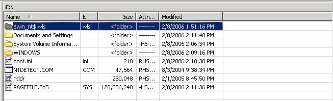

Heres a shot of the file system just after the error has occured. This is being viewed through Bart PE its the $win_nt$ folder thats confusing me. Ive copied the OEM folder into $OEM$\$1 as you stated above and amended the batch files but it still does not work. The $OEM$\$1 is actually within that $win_nt$.~ls folder and you can see the OEM folder within it. Just need help with the EXACT lines you changed in the batch files and what EXACTLY you changed them to! Please help dude! -
Thanks although a OEM folder is also not present on the RIS structure? Have a look at this thread the guy has exactly the same problem and said he fixed it. He has not gone into great detail how though. Have you any idea exactly what lines he would of amended? Im looking at a ghost image of the disk taken just after that error and all the required files seem to now live in C:\$win_nt$.~ls\$OEM$ http://www.msfn.org/board/index.php?showtopic=66624&hl=RIS The thread is above
