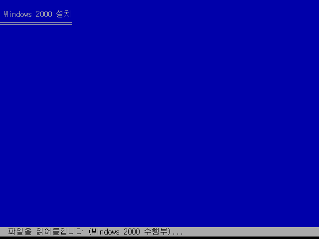

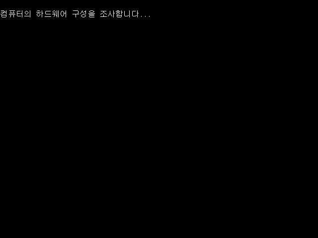

  2. In Windows NT 4.0 and some 2000 beta builds, "setup is loading files", "setup is inspecting your computer's hardware configuration", etc... are localized to each language. Translation: "Setup is inspecting your computer's hardware configuration" (above), "Setup is loading files (Windows 2000 Executive)" (below) I opened SETUPLDR.BIN in notepad++, then found several localized strings. but it can't be modified on most resource editors, since it is not 32-bit file. So How should we add localized strings to that file?

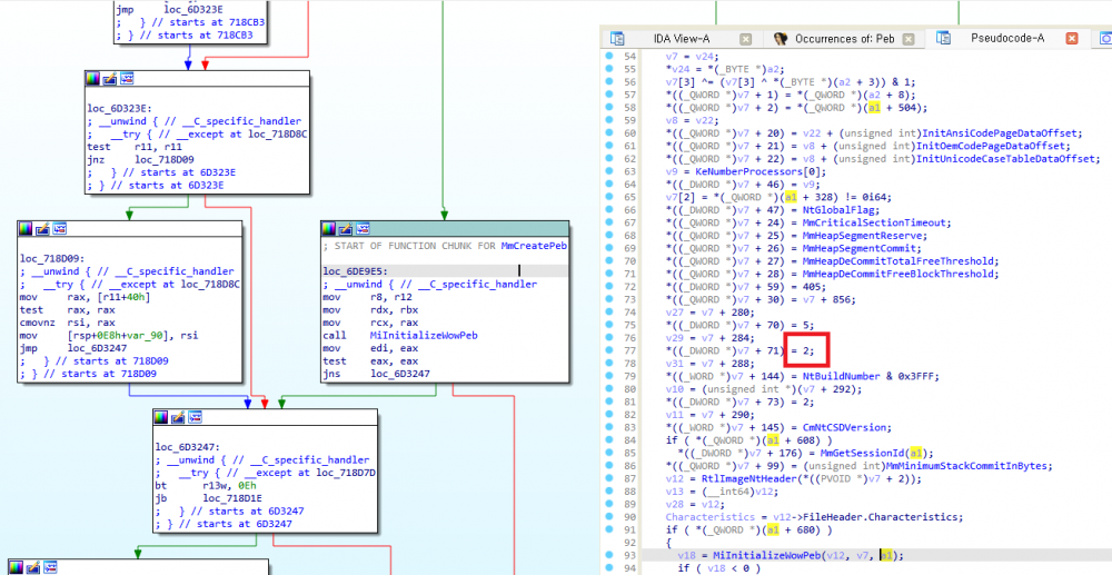

  3. Thank you so much!! I found major and minor near MmCreatePeb function

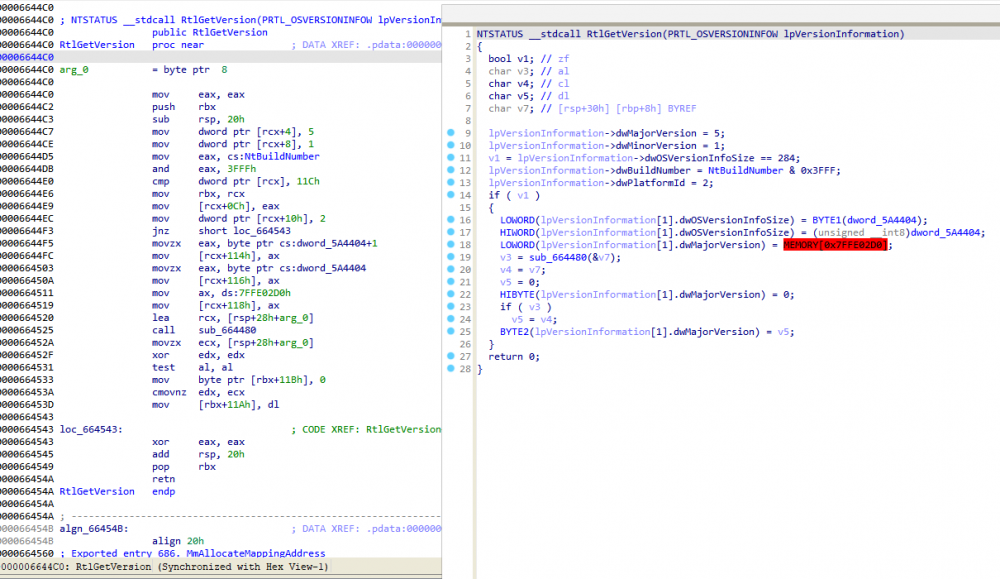

  4. I modified RtlGetVersion and PsGetVersion both, but version is still 5.2

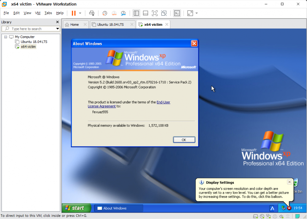

  6. If you want change 2000, XP x86's version and build number, use imagecfg! for Longhorn, modify ntoskrnl or ntkr**** via hex editor. (follow this guide!) But in case of XP x64, imagecfg doesn't work and I can't find where major and minor are in ntoskrnl.. Does anyone know where they are? I was able to find build number in ntoskrnl, so version is 5.2.2600 now

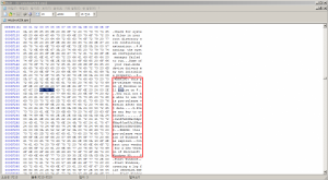

  8. I've removed the timebomb of windows 9x by replacing io.sys, but some beta builds' logo was changed retail boot logo [non-beta logo]. So I decided to find the another way of removing timebomb. For example, disassembly io.sys [or winboot.sys from precopy1.cab in 9x setup] and find the address. But I don't know how to remove timebomb. (I found the sentence 'ERROR: This pre-release version of Windows ** has expired.' and 'WARNING: this pre-release version of Windows will expire on $' by opening winboot.sys.) If you don't know 'remove the timebomb by replacing io.sys', please click below address. http://www.betaarchive.com/forum/viewtopic.php?f=39&t=10569
