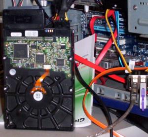

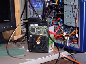

	After a bit of experimenting I found some interesting facts. To view the Pagefile.sys file along with checking "Show hidden files and folders" you must also uncheck "Hide protected operating system files (Recommended)" (you might have clarified this little much needed step Jaclaz ) XP 32-bit will give you the ability to use a USB card as VM, BUT that is not where is places the pagefile.sys. It uses your C: drive. I set the VM to 2048 and the pagefile.sys appeared on the C: drive as 2048K. When I changed the size in the VM window, the size of the pagefile.sys in drive C: also change to match it. While I could not get XP x64 to use a USB card, it did allow me to use the external USB HD. But again, it placed the pagefile.sys on the C: drive and any changes to the size on the external was matched on the C: drive. Leave it to Microsoft. One other interesting item.....if you do not set any VM on any drive, XP and XP x64 will put a pagefile on your C: drive, like it or not. Ponch, it looks like Jaclaz has answered your question. And Jaclaz, that drive was connected externally thru the USB So, now that I have discovered the real way that XP and XP x64 do VM on USB devices, I guess my question has been answered. Now, off to read those websites.............

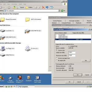

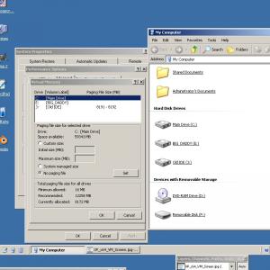

	First, let's put this thing of 'if you can do this you should be able to do this' to rest. You think maybe 5 strokes, epilepsy and a portion of my brain being surgically removed to keep me alive may have messed up my ability to understand what I tend to call 'foreign languages'? Now, to settle a couple of more things. Yes, a USB card can be set up to be used as VM. At least on XP 32-bit. That is a Kingston DataTraveler DTI / 4GB on my wifes system for this shot. I have used it on my system for several years. Here is a Hitachi 61.4 GB hard drive attached to my present system, XP x64. And the VM settings ( the HD is named 'Old IDE' ). But, here is where I attempted to set up the Kingston as the VM. As noted before, it just does not show up. Now, back to the last post........ I never said I was ignoring the fact that a hard drive is faster than the solid state USB card. I'm well aware of which is faster. I'm also aware that a hard drive has a limited life span, I've lost a few, including over 5000 photos of railroad equipment. Many present drives only have a 1 years warranty, which is why I just purchased and installed 2 1TB drives and a RAID controller card to handle them. One dies, I still have my work on the other. And I'm not a NOOB, I've been building and working with computers since the early 80's. Just because I have never had a previous need to dig into the firmware of them only makes me uneducated with the firmware, not the whole thing. A person can build many systems, put a 20-year-old company on computer using a network ( a 2 wire network), rewrite programs, create maps for games, decipher and enlarge a game ( http://www.sidmeiersrailroads.net/portal.php ), and much more, without knowing what a 'pagefile' is and never having played in the Windows Registry. I'll look over and READ the sites you listed. I'll do my best to shut down any present personal problems so I can understand them better. You have my thanks for the time you spent doing the research. Minus the attacks you seem to enjoy throwing at me. (do you tend to attack all people that stand lower on the ladder than you?) Now, a bit of my flipping thru the internet. http://gadgetwise.blogs.nytimes.com/2011/07/19/qa-the-lifespan-of-a-flash-drive/ ( Quote: With proper care, a flash drive could last years. ) http://www.worldstart.com/flash-drive-lifespan/ ( Quote: some studies estimate that recent flash drives can tolerate millions of flashes before they wear out. ( note: newer hard drives have only a 1 year warranty ) ) A 16GB SEgoN Mini-Ding list for $13.99 and a 32Gb for $18.99. Much less than the replacement cost of a hard drive. ( http://www.newegg.com/Product/Product.aspx?Item=9SIA0U90BU5037 ) And then there are these: http://www.google.com/#hl=en&tbo=d&sclient=psy-ab&q=flash+drive+as+virtual+memory&oq=flash+drive+as+virtual+memory&gs_l=serp.3..0l2j0i5j0i5i30.491.6841.1.7016.17.9.0.8.8.0.192.1306.0j10.10.0.les%3B..0.0...1c.1.MmX6nbWJq2Y&pbx=1&bav=on.2,or.r_gc.r_pw.r_qf.&fp=a0e192af6a1c269e&bpcl=38093640&biw=1567&bih=769 No, I haven't read them......yet, but I plan to. I'm going to take a day off from rebuilding my house. But first I'll read the sites you posted.
