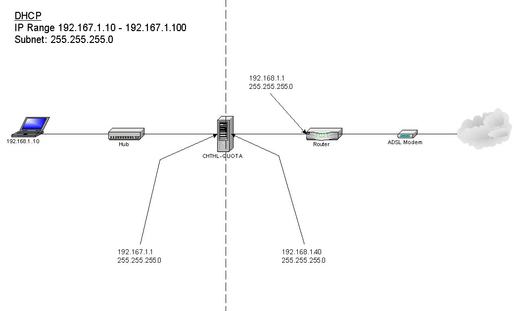

  5. hi guys! i've got a small but a complex problem. First look at the attachement to see, how my network looks like. I need to access \\CHTHL-QUOTA\image from the Hub, and from the Switch. The problem is.... On Workgroup network, my laptop is connected to de Hub. Now i can access CHTHL-QUOTA with a username and password (local user of CHTHL-QUOTA: EUC). But if my Laptop is connected to the Switch (EU Domain) AND is member of EU Domain, CHTHL-QUOTA will Deny my access to its share. Even i access the share with the user EUC and the same Password i used in Workgroup network. So what can i do? is this a policy Problem? btw. CHTHL-QUOTA is not in EU Domain. My english isn't too good , so i hope you'll understand it...
  6. ah okay. Done! I now have installed de NETBIOS/NETBEUI/IPX Protocol on the server. Then i got an "Access denied" in DOS on the laptop. But at last i could map the shared folder with NET USE G: \\CHTHL-QUOTA\LTXP ! So now i looked at the local policies. I changed the values of some MICROSOFT NETWORK CLIENT and DOMAIN MEMBER policies. Looked at the User And group rights too. Now it works!

  8. Ive got a small network. I have to map a shared folder from CHTHL-QUOTA to the Laptop so i can start Ghost. In CHTHL-QUOTA i configured a DHCP server. my only problem is, that i cant ping CHTHL-QUOTA with name, only with IP (192.167.1.1).
