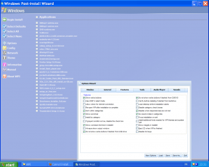

  1. Hi thanks for quick reply... I went in to options but could not see anything for sort by numerics. I did manage to untick install by category and tick sort within categories which gave numeric then alpha from the file name (see image). Ideally i would prefer that it understood the numerical column but i cannot see the option, it certainly gives the option of numerical sequence in the config tab although you have to manually insert the number. I presume that the Install Order box in config requires numerics ? Just checked it does not allow alpha selection....

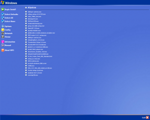

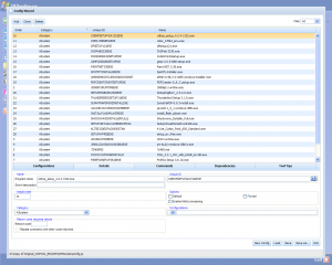

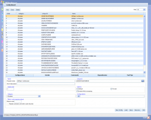

  2. I have configured WPI with the programs i would like to install, and constantly saved the config as i added the apps. My problem is that although i saved them in the sorted numerical order before i save and exit the config page, once it goes to the opening screen or re-entering the config screen again it is never what i saved it as. I have installed this to hard drive but it is not in the sequence that i wanted. How do i get the sequence i want as it does not seem to follow a numerical order nor by the looks of it a alpha order either. Attached are screen shots Thanks
