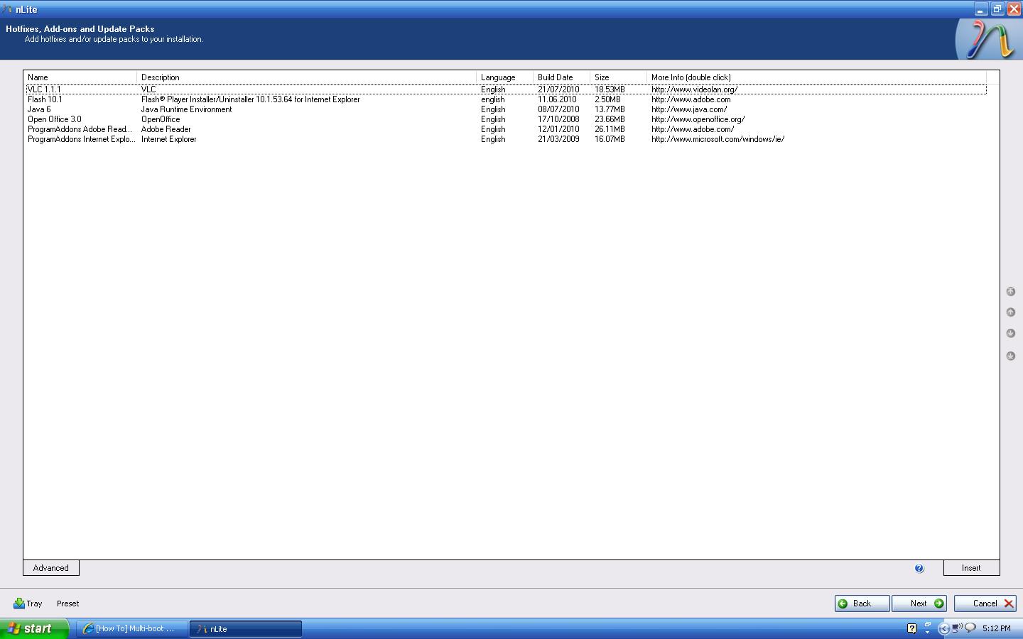

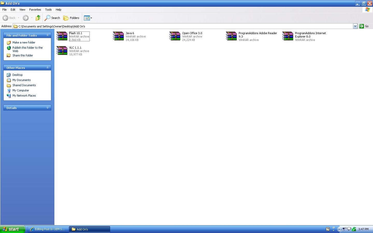

	Tdunk18, you can run nLite under VMware. I am not familiar with some of the terms you are using (slp, aio). I hope you are not using nLite in a work environment. The nLite license only allows personal use. It is available in the nLite folder in the Program Files folder. Please give it a read. Assuming you are OK with the license, please do post more information. The more the better. We like to see screen shots of error messages (another advantage of testing under a VM). We will take at look at oemscan, but know nothing at this time, so we should attach other problems first. Enjoy, John. Okay well here is an update to my current struggle with nlite addons. I added 6 total to it and only adobe reader 9, IE8, and vlc worked. I have attached a picture of the addons i was using. Mainly this is the software i want nlite to install for me. The lastest openoffice, flash, adobe reader, vlc, java, and IE8. Are the addon's broken maybe? and do you guys know where i might find one / easily create one. I also did all of this on windows xp media center edition. Hopefully thats okay?. The drivers from driverpacks installed fine. It would be great to if i could use nlite to install microsoft security essentials but i'm somewhat doubtful it could. I also went ahead and did not include the oem pre activation at all since i need to get this stuff working first. Also do you guys know a link to microsofts generic install keys? the ones that will let it install but not activate online. I need that for the pre activation and am having trouble locating one. Last Session (2010.08.03-11.34.42).ini
