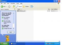

Microsoft security essentials did not install it only shows this. (picture attached) Last Session.ini

perfect thats exactly what i did! thanks for the picture that helps ALOT!. Haha i dont suppose you know the answer to my oemscan autoactivation question do you haha? Least to get it working hmm i wonder if i can download the addon extract it add all the keys into the files then use the addon utility to like maybe issue a switch to run the software during windows installation is that possible? The actual activator is an exe?
