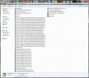

Hello! I am new here and i'm from Greece so i'm sorry for the mistakes there might be:$... I want to slipstream some updates to MS office 2007 with "Office 2000/XP/2003/2007 Slipstreamer - version 1.7.4". I downloaded 47 updates with "wsusoffline651", but when i tried to browse them with the slipstreamer i could select only the 19 of them.... I noticed that i could select only updates with specified name (eg. *kb*fullfile*.exe*) but the most of them have name such as "ndp20sp1-kb953300-v2-x86_b19b1a3f0ff00153e0ee2a71f6707803ef482046" or "ndp20sp2-kb971111-x86_9bc3ccd477d035f9278d93df9f8c8543c156b2ca", I have attached a photo to see the names of the updates which wsusoffline651 downloaded, can someone help me?
