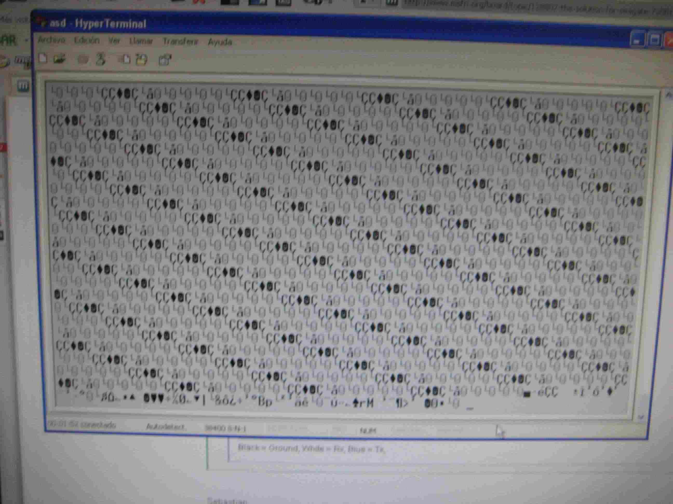

Hi mundy Thanks a lot for your tips Here is my cable and a screen capture of what kind of things i see when i run Hyperterminal (i see them randomly, sometimes i connect and nothing happens. Sometimes i connect and it looks like the pic) BTW, box is similar to the one above. My cable is from Chine but packaging is exactly the same I hope this can be the beginning of my solution....hope the pics are good for you -

Hello everyone. This is my first post here, even tough i have been reading all the info in this thread for the last days Im, like many others here, desperate. I have absolute no knowledge of electronics or something like that. I was using my PC. Turned off. Next morning, Barracuda HDD wasnt recognized. I can hear the spinning but thats it. BIOS no longer recongized the disc. Thats why i guess i have the "brick" mode. I have run even the soft which i previously burnt in a CD, booted with that and the HDD was not shown there also... im very afraid i have "ruined" the drive... I have (and i fully know its my fault)all, and i mean ALL my precious and all my important info in that HDD (i bought it not many months ago). Among other stuff, i have ALL the pictures taken with my camera since i own one, including my sister´s wedding and my best friend´s wedding, all my collegue papers, info, ebooks, documents including my final thesis and stuff like that. again, i know i should have done a backup before, but thats exactly why i bought this HDD. I have tried for the past few days with no success to connect the HDD to the USB port. I have tested and broken 5 different CA-42 cables, with different colours and amount of cables. With the first cables i couldnt even install the USB driver (i received an exclamation mark and the USB-URLA device not installed properly and couldnt find the **** driver over the net, even tough i tried everything including Nokia´s driver) After buying my second batch of cables, i managed to install them properly but...i received a "COM3 port is already in use by other device". I tested that with at least 4 different COM ports with no lucks Finally, the last cable i bought (they are not original Nokia branded but other ones very common generic (and lot cheaper) in my country (Argentina) was installed succesfully (COM3). I entered Hyperterminal. The longest i could go was i got strange characters...then, absolute nothing. Nada. I have no idea how to identify which cables are TX and RX. Have no way of measuring, nor electronical skills. I dont even know if i have done right the job of putting the cables in some old pins i have from an old Pc cable. So i cant even be sure if the cables are actually doing any contact with the HDD pins and thats why i got nothin gfrom Hypertermina. I have followed exactly all guides with the last details here (included the one in spanish) with no results at all. So, i have nowhere to go. I dont know anybody here in my city (Buenos Aires) who would help me. Thats why im asking desperately help here If anybody has already used a cable with success, i would love to buy it (i can pay a very good money since i have invaluable data on that hard drive) and im close to giving up , resigne, cry a little (or a lot, for the loss) and throw the hdd to the garbage. Please, please, somebody help me. I am willing to pay for an already made cable/adapter/whatever who has already done its job perfectly, so i can fix my disc. Any help/tips/hints/advices/suggestions are more than welcome, even if they are a how-to-for-dummies-like-me with pictures about what im doing wrong/what else do i need/how to know which cable is which, etc etc etc. I have no tester/multimeter or such a tool and i remotely know how to use it. You guys are my last resource. And believe me, im very very sad, and depressed. I have vaguely slept in the last few days. Im like a zombie, all day thinking about the **** disc and blaming it, and blaming me....and buying new cables CA-42 (or DKU-5) in order to achieve this...with absolutely no success... Please, i beg for your help Kind Regards Sebastian
