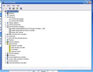

That is what it said under the mass storage controller.... maybe it is for the flashmedia, this laptop does have that... so maybe it has nothing to do with the harddrives at all??? I formatted the other harddrive and now I have all 120GB to use... I dont see a need to re-do anything at this point...

Mass Storage Controller Hardware ID's PCI\VEN_104C&DEV_8033&SUBSYS_00011179&REV_00 PCI\VEN_104C&DEV_8033&SUBSYS_00011179 PCI\VEN_104C&DEV_8033&CC_018000 PCI\VEN_104C&DEV_8033&CC_0180

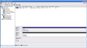

@Fernando Sorry, I didnt realize you wanted me to use one driver or the other... I clicked on the link where you posted the special Qosmio drivers, I didnt know those were old I am going to assume that your modded drivers did the trick, as the other drivers I got from the toshiba website did absolutely nothing... and you seem to know what you are doing Since the installation went smoothly, I am not going to re-install or anything to see which drivers actually did the trick, but like I said, I am sure that it was the modded one @ricktendo64 Thank you for the suggestion. I would have tried that method if I didn't get so many responses so quickly, but I wanted to be sure it worked, so I was looking for specific drivers, not just a huge pack that may or may not have the correct driver. I wasted too many DVD-Rs already on my own lol heres a screenshot, I don't see "SCSI and RAID Controllers" anywhere... they are both in JBOD mode, maybe thats why? Or is it the yellow ? named Mass Storage Controller? Here's a screenshot of Disk Management @
Hey guys... Fernando, I used both of the ones you posted... the special one for the qosmio G and your modded Intel Matrix storage drivers for ICH6M... I dont know if one or the other did the trick, so I included both just in case.... When it asked me to add drivers in nLite I just selected them all and integrated... Here are my last session.ini I didnt know how to add both sets of drivers in 1 nLite session lol: Last_Session.ini Last_Session__2009.11.23_18.54.34_.ini But as you can see I just added all drivers in both sets, made an ISO, burned with Nero, and it worked! I'm assuming its using the iastor.sys, that's what was displayed when it was formatting the HDD anyways... Also, the other 60GB HDD was shown when i was formatting... currently both are set to JBOD, but windows only sees the 1 60GB HDD, so how do I make use of the second one? I'm new at the whole RAID/multiple HDD thing...
