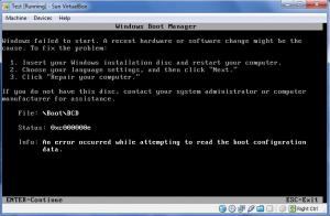

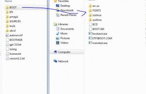

  12. I downloaded UBCD 5.0b12 and updated the syslinux/isolinux files from syslinux 3.82. I am using Sun Virtual Box to test these ISOs. C:\ubcd-stripped\BOOT\BCDC:\ubcd-stripped\BOOT\BOOT.SDI C:\ubcd-stripped\BOOT\BOOTFIX.BIN C:\ubcd-stripped\BOOT\etfsboot.com C:\ubcd-stripped\BOOT\isolinux C:\ubcd-stripped\BOOT\syslinux C:\ubcd-stripped\BOOT\isolinux\isolinux.bin C:\ubcd-stripped\BOOT\isolinux\isolinux.cfg C:\ubcd-stripped\BOOT\syslinux\chain.c32 C:\ubcd-stripped\BOOT\syslinux\ldlinux.sys C:\ubcd-stripped\BOOT\syslinux\memdisk C:\ubcd-stripped\BOOT\syslinux\menu.c32 C:\ubcd-stripped\BOOT\syslinux\reboot.c32 C:\ubcd-stripped\BOOT\syslinux\syslinux.cfg C:\ubcd-stripped\BOOT\syslinux\vesamenu.c32 Yes see above. I downloaded the Vista Recovery Environment ISO from here: http://neosmart.net/blog/2008/windows-vist...-disc-download/I downloaded the 32bit edition, extracted with 7zip and properly renamed the files and folders to all caps (see above). I confirmed that the plain ISO boots to Vista Recovery environment. BCD file is default one from this ISO and not modified. etfsboot.com was not included on this iso so I downloaded it from here: http://www.mydigitallife.info/wp-content/u...01/etfsboot.com isolinux.cfg entry DEFAULT main LABEL main KERNEL /boot/syslinux/menu.c32 APPEND /ubcd/menus/syslinux/main.cfg and then ubcd/menus/syslinux/main.cfg looks like this: MENU INCLUDE /ubcd/menus/syslinux/defaults.cfg DEFAULT /boot/syslinux/menu.c32 PROMPT 0 LABEL - MENU LABEL BOOTMGR COM32 /boot/syslinux/chain.c32 APPEND boot ntldr=/BOOTMGR MENU SEPARATOR LABEL - MENU LABEL Boot next device TEXT HELP Boot next device in the boot sequence. Supporting BIOS required. May not work with all systems. ENDTEXT LOCALBOOT -1 LABEL - MENU LABEL Reboot TEXT HELP Reboot the PC ENDTEXT KERNEL /boot/syslinux/reboot.c32 APPEND - MENU SEPARATOR ISO size is 385mb with ubcd and the Vista Recovery environment. With the ubcd files and BOOT.WIM stripped out its 5MB. I am using the one included with UBCD 5.0b12 = mkisofs 2.01-bootcd.ru (i386-pc-mingw32) I tried both the those mkisfofs lines and the result is still the same (File: \Boot\BCD Status: 0xc000000e Info: An error occurred while attempting to read the boot configuration data.) The way I create the iso is run administrator command prompt, CD c:\ubcd-stripped\ubcd\tools\win32\ubcd2iso\, and then run either ubcd2iso or ubcd2iso1 or ubcd2iso2. the script variables are: (script) (ubcdfileslocation eg. c:\ubcd-stripped) (location/name of what i want the ISO to be eg. c:\ubcd-stripped.iso) ubcd2iso = original build script from ubcd 5.0b12 ubcd2iso1 = modified mkisofs line to look like first one in quote: "%~p0\mkisofs.exe" -iso-level 4 -l -R -J -joliet-long -D -V %VOLUME_ID% -o "%a2%" -b "BOOT/isolinux/isolinux.bin" -c "BOOT/isolinux/boot.catalog" -hide "BOOT/isolinux/boot.catalog" -hide-joliet "BOOT/isolinux/boot.catalog" -no-emul-boot -boot-load-size 4 -boot-info-table -graft-points /BOOT/etfsboot.bin=BOOT/etfsboot.com . ubcd2iso2 = modified mkisofs line to look like your second one in quote: "%~p0\mkisofs.exe" -iso-level 4 -r -joliet-long -D -V %VOLUME_ID% -o "%a2%" -b "BOOT/isolinux/isolinux.bin" -hide "boot.catalog" -hide-joliet "boot.catalog" -no-emul-boot -boot-load-size 4 -boot-info-table -graft-points /BOOT/etfsboot.bin=BOOT/etfsboot.com . Please feel free to download the files I provided in the beginning of the thread. They are the same files I am using. What do I seem to be missing? thanks, dpc
  13. I have been trying to get this to work for a while now and so far nothing I seem to be doing can get it to work properly. On USB it works great but as soon as I get it into ISO format the BOOTMGR cannot find the BCD file it seems. Can anyone give me a hand? Alternatively is there another place I could ask? thanks, dpc
