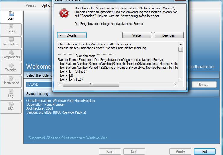

  2. Dear MagicAndre1981, dear RBCC, today I sucessfully removed components from a technes msdn M$ Vista SP2 RTM ISO. BUT my own reverse integrated version does'nt work with the same procedure. So I searched the forum once again. I could'nt found more people with the exact error but I found some .NET exeption handles + some possible solutions to resolve. One suggestion was to downgrade from vlite 1.20 -> 1.1.6. THATs IT. This worked for me too. Now i can remove components from my own ISO. Maybe somebody is interested to know this? Bye Thomas

  4. Dear fellows, I did my final tests with my reverse slipstreamed SP2 and vlite. Because vlite would'nt load the *.wim on my 1st preinstalled HP-OEM system, I promised to test on the running SP2 system. The problem is the same. But this system IS a german one, with german WAIK+wimfltr.inf, with german .NET and german vlite. So I don't know where the language conversion error relates on. Is there any possibility to do the extraction of unwanted applications anyway else? How/what does vlite do to remove some stuff? Best regards Thomas
  5. Hi you all, now, I would like to report you of my big surprise yesterday evening. After submitting my last reply to you I gave the vista setup one last chance. Surprise: it installs flawless!!!!! This was my intension to download another sliptream/integrate tool - the VUI 1.0beta5. http://www.winvistaside.de/downloads/syste...-integrator-47/ This tool runs/loads flassless too. So I can send you the following matrix of tests. ImageX imageX imageX Version Waik1.0 Waik1.1 vLite 1.2 -------- -------- VUI 1.0b5 XXXX XXXXX VistaInst -------- XXXXX Relating the VistaSetup is behaves like described in the 7th post on this website. http://apcmag.com/how_to_slipstream_vista_...install_dvd.htm Relating the vlite problem I only have one idea and will test it today. Your hint with the english vista/.NET could be the reason. I have to explain that all my done splipstream/integration work is to replace my preinstalled HP-Pavilion OEM Recovery Vista Version. I hate the Crapware and the missing hotfixes/ patches. Of course I execute vlite on that system. Maybe it was an english one with only an german sliptreamed language pack??? So I will run vlite on my new SP2 partition loading the install.wim. The new installed vista shows SP2-Version in system but does'nt do that in add/remove. Is this because I run the vsp1cln.exe and compcln.exe after installing SP's and before generalize???? I red uninstalling is unavailabe then. Bye + you are the best Thomas

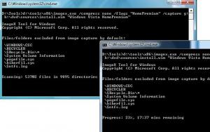

  6. Hi fellows, as I promised here are the attached pics and logs. The change from waik1.0 imagex.exe v.11.2006 to the waiksp1.1 imagex.exe v08.2008 does'nt help - same errors. I dont know what i'm doing wrong. It can't be as tricky as it is on my pc because MS uses the same way and recommends it for home users too. I know the competitor vlite is'nt loved in Redmond Hope smebody can help me. Bye Thomas vLite12Error.txt

  8. Dear folks, thank you for the fast reply. My first tests were... VistaSp0-Audit Mode-SP1-reboot-SP2-reboot-generalize (RTM from 28.Apr.2009) Because this results in the error, my second tries were... VistaSp0-Audit mode-SP1-reboot-generalize Even the same error... The show must go on, so I installed... VistaSP0-Audit Mode-NO CHANGES!-generalize After that I used the command... imagex.exe /compress maximum /flags "HomePremium" ......... "Windows Vista HomePremium" Consider, there was nothing changed on my last try but the error is the same if I would do so. I forgot to mention that the command imagex.exe -info....... results in the same overview my original purchased install.wim results in. vLite 1.2 can open my original VistaSp0 without any errors, but not the "homemade" version I have no further idea. @MagicAndre1981 Hi MagicAndre1981, was ist in vLite mit Eingabezeichenfolge gemeint? Gehe ich zu den Fehlerdetails erscheinen einige Compiler Parameter $String... u.s.w. Da hört es bei mir leider auf. Best regards Thomas
